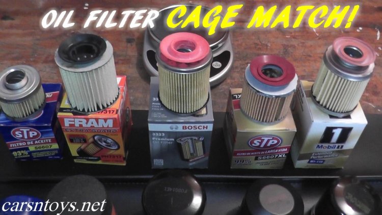

The only special feature the filter could possibly have is an anti drain back valve.  All good filters that meet the specs for that engine will have this feature.  I use Amsoil filters because I like them.  Use what you like.  Do some filter research.  They are not all made the same way.  Check out bobistheoilguy.com.  lots of really good analyis and comparison.

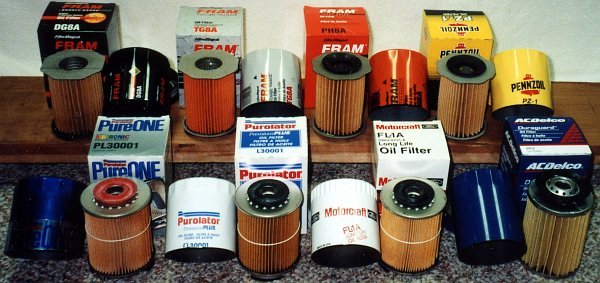

An oil filter is an oil filter. You can spend $15 or $2 on a filter. They both cost the same to manufacture, and have the same minimum performance standards. They are all acceptable according to the vehicle manufacturer. They are pretty much all made the same way and with the same materials. Many different "brands" are made by the same manufacturer. Some people say "I ALWAYS use the best for my car! Best oil filters, best oil, etc". Use what ever makes you happy. As long as you change your oil every 3k miles, keep the fluid levels up, and don't overheat it, your engine will last longer than you need it to.

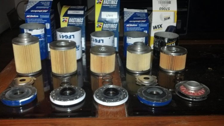

I use to be a huge fan of Mobil 1 when it was still a POA but now that it's a hydrocracked mineral oil it has placed itself on the same level as (most) any other 'full synthetic'. All but my best stuff gets Quaker State UD now. Sits right next to Mobil and is about $3-$5 for five quarts cheaper. I wouldn't hesitate to use Valvoline, Castrol, or even Pennzoil (since Shell got control) Full Synthetics these days to 5K. Dad uses some Farm/Fleet Full synthetics to crazy motor lives on 7.5K changes in my sisters car but...she drives almost 100% highway and long distance (work). Blends and straight mineral oils 2.5K...3K tops.
On filters I use to use Bosh Premium or Mobil 1 when I couldn't find a Bosh. Today I use WIX or NAPA which is made by WIX. While they all pretty much look the same inside there are some media differences. Bypass spring differences. And some difference in the bonding of media to plate. Anyway the WIX (made by WIX) is just as good, better IMHO, as the Mobil or Bosh (made by Champion) and half the price.
