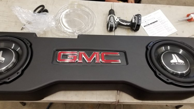

Ya it hits hard with that setup. Or get this built for cheaper and you'll be heard at the stop light lol
What do you got there brother? And we would have to lose that GMC asap for my build! haha
That looks great!  How much would this cost installed at your shop?
There's 2 12tw3 in that enclosure
Enclosure is $700 and subs are $500 each. This is all in CDN pricing
12 hours ago, CovetedStyle said:
Would that jx1000 push those or would it need more power?
Ya the jx 1000 will be able to move them. Make sure u get the 8ohm subs. Have them wired in parallel @ 2ohms and you will get max output from the amp
