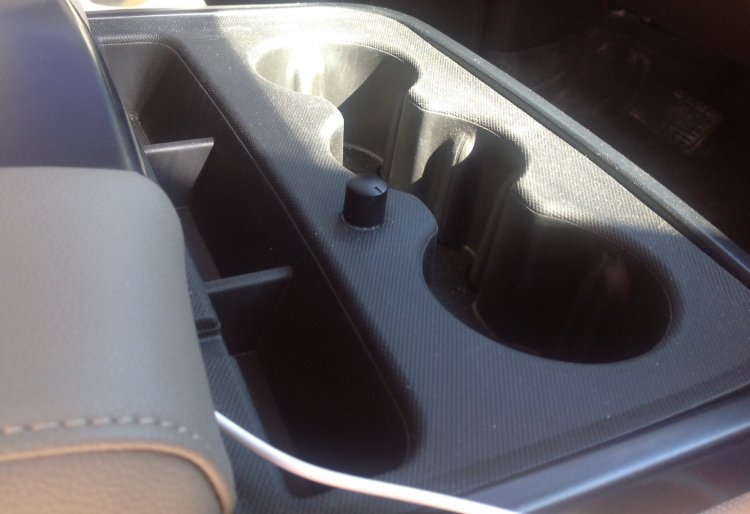

What is this bass control knob, where do you mount it?

The remote bass control knob is just that a Knob you can mount up front and allows you turn up or down the amount of bass easily from the front seat.  I usually mount them in vehicles right beside the hood release lever under the dash but really they can be mounted anywhere you desire just like the example above.

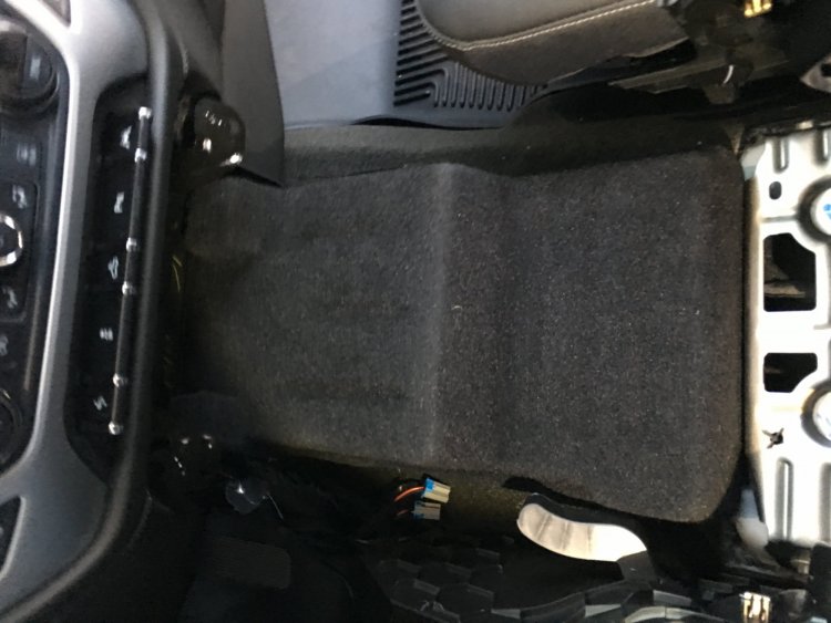

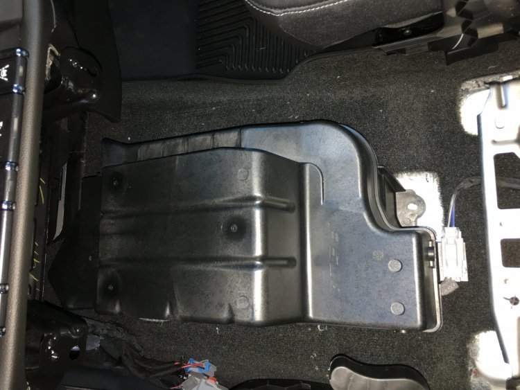

I just replaced my factory 5” Bose subwoofer with a JL AUDIO Stealthbox 10” subwoofer.
The factory Bose system sounded good but low end bass was severely lacking especially at mid (1/2) to high volume (3/4)
I left the 4 door and 2 dash speakers Bose and the stock 175 watt Bose amp. Adding the 10” JL sub and 300 watt at 2 ohms JL amp, system sounds perfect now. IMHO.
I like how this stealthbox fit under center console so I didn’t have to sacrifice under rear seat space.
Center console was fairly easy to remove.
Open armrest top top and pull up on lip to remove the entire fake wood, cup holders, usb, ac top piece.
Then 6 10mm bolts.
Then 2 14mm? Bolts on rear bottom near back seat storage on lower back sides.

Hey all just wanted to say the single jl stealth box Sounds great and is a huge upgrade from the Bose sub. I now understand why the bose sub did not hit as hard or at such low frequencies. Whatever is in your center console will vibrate and Rattle now LOL
I now have massaging seats, massaging center console, and massaging door armrest, Depending on the bass line. The single 10 inch JL vibrates the rearview mirror no problem.
 Now I’m noticing an annoying squeak and rattle on the passenger side dash near the dash Bose speaker. It is not the speaker blown or anything. If I turn the sub down and just run the bose door – speakers there are no squeaks or rattles but as soon as you start running the sub hard you start noticing squeaks and rattles.

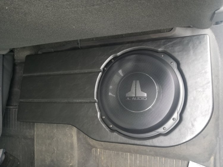

DUB1796, where did you purchase that box? The one with the GMC logo. Have you been happy with that? Thank you!
I built it for a customer. That's my go to enclosure for the sierra/silverado, it hits hard. If your looking to buy a similar enclosure within the US, check out MTI acoustics.

All jl sub stealth boxes produce more then enough bass for most people. I prefer 12s bc they hit the lower notes compared to 10s. This is what I built for myself.
