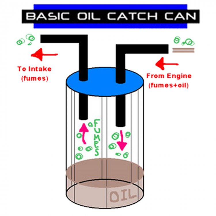

No idea if this is relevant to your vehicle, but I have seen certain engines that need a will use oil with the OEM PCV valve. You may be able to resolve the issue by getting a differently designed one. Some people solve this issue by installing a simple catch-can on the breather tube. I would try to build/buy one that will self drain back into the motor when you shut the rig off. I had the same setup on a go-cart once, and it worked great. Much less oil burning.
Never put the contents of a catch can back into the oil!  There will be water, oil, fuell, acids and other contaminants in it that you don't want back in the pan.
Unfortunately for the op, it sounds like rebuild time.
My go cart was farting out about 1 quart of oil into the catch can every half hour of driving, so having it drain back into the motor was a necessity. On a regular vehicle, I would throw the oil away - unless it was a huge volume of it coming out of the motor.
