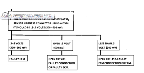

Code 13 will set when:
Engine at normal operating temperature
At least 2 minutes engine time after start.
Oxygen sensor signal voltage steady between .35 and .55 volts.
Throttle position sensor signal above 4%.
All conditions must be met for about 60 seconds. If the conditions for a Code 13 exist, the system will not go "Closed Loop".
This is exactly when the light comes on [typically will trigger at any cruising speed [30-80] But only while cruising ( i assume to meet the TPS sensor above 4% for 2 minutes). It triggers more 'easily' if you can imagine what i mean, at higher speeds [80mph]. The light will turn off if i go WOT for a few seconds, if i idle for a few minutes [at a stop light], or if i'm driving around town. The light wont turn on when driving around town.
Another note: The DTC flowchart asks to probe the O2 Harness Side to Ground - should read 0.3v to 0.6v.
Mine is reading 1.48v so i checked the "open at 413" error and the ground connection is good, ground strap was cleaned and terminals were cleaned so the only other error it says is that the ECM is faulty, which i just simply don't believe. The truck runs absolutely beautifully except for this code.
