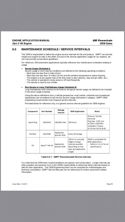

I posted this in another thread but it’s worth bringing up here too. GM powertrain recommends Dexos 5W-30 when they sell these engines to OEMs for marine, industrial or recreational use. They clearly state their recommendations are only meant to be a starting point and the OEM must decide the correct maintenance based on the use of the engine. I’d say towing like that justifies upping your viscosity as you fall into the severe use category which they also state is a comparable to how they expect engines to be used by the OEMs they are supplying.
