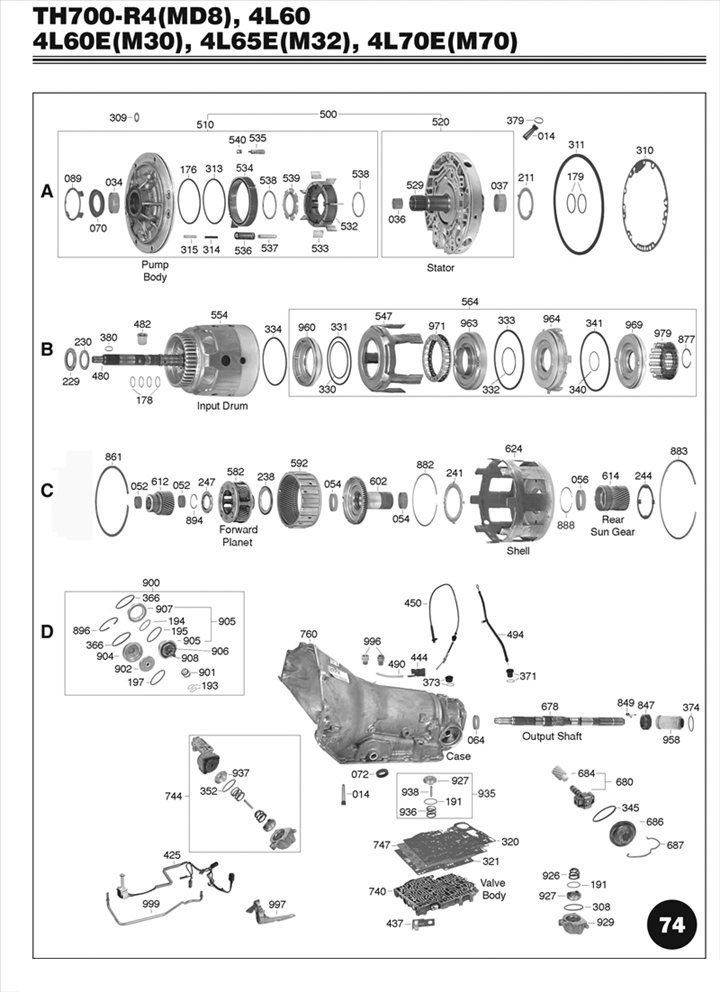

Did they drop the pan and replace the filter? If they did they might have knocked one of the connectors off of one of the shift solenoids when they were putting the pan back on. Seen it many times before.It is a very close fit getting the pan back on around the engine pipe. Scan for codes and see if any shift solenoid codes are current.The default is third gear and full line pressure. An easy fix if thats the problem.

It does sound like a solenoid issue. Smart not driving it. I would attempt to let the dealership fix it, not much can go wrong with a drain and fill pan drop as long as they did not "catch" the wiring harness on anything. On my 2001 Yukon I have to unbolt the tranny mount and jack it up about an inch to clear the pipe in order for the pan to come off.

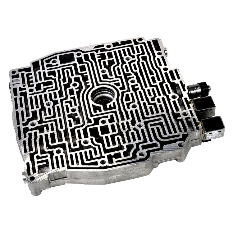

 Problem #1: As the fluid gets old, the detergent stops working. Crud builds up on the inside parts. When you introduce new fluid, it loosens that crud up and it clogs the valve body.

Don't use the pressure fluid exchangers either that most stealerships will use. These will run new fluid in different directions, causing loose crud material to jam up valve bodies.

As for your problem, sounds like you are stuck in limp mode. This is default when the trans is getting no power. Make sure the wire harness is plugged into the side, pull it and reset as well. Check fuses. After that, check dtc codes.
You could have a clogged valve/valve body. May need to pull and rebuild the valve body - but check limp mode symptoms first.
