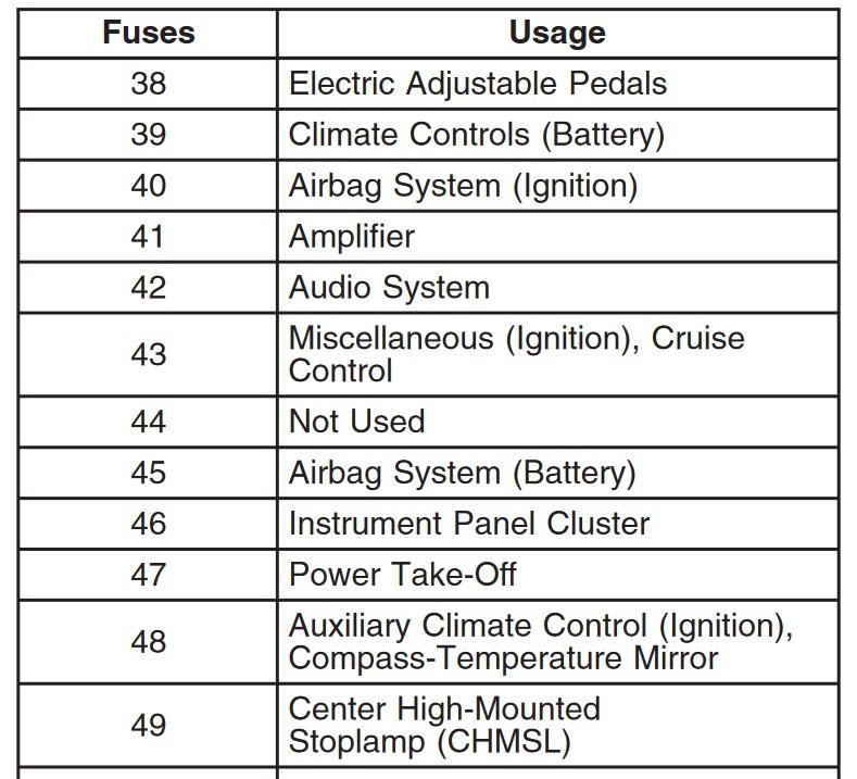

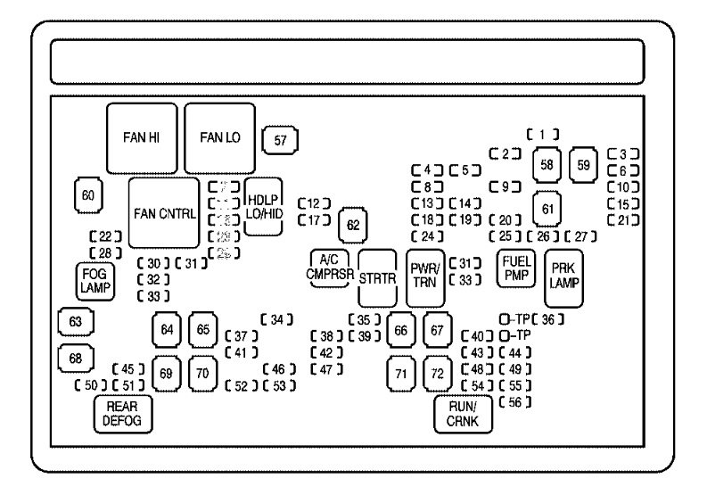

Did you check the fuse?  Fuse #43 in the underhood fuse block...
in there now, the fuse is fine, little white crusty I scrapped it clean and wiggled it back in and out a few times. no change :(

Check to see if the fuse socket has power, using a voltmeter. One side should be hot, the other not. You will want to confirm that the entire system has power. If not, where does it stop?
