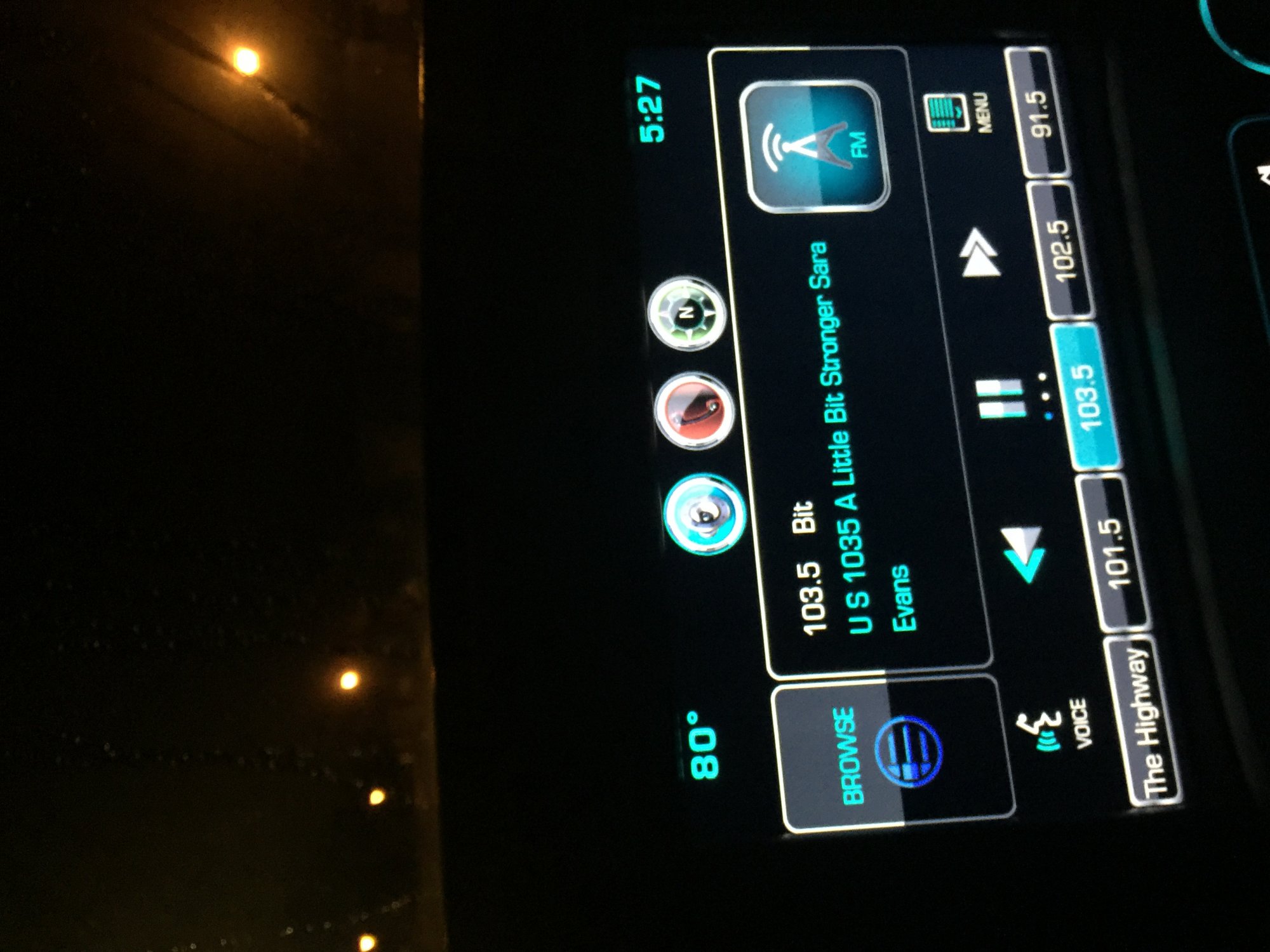

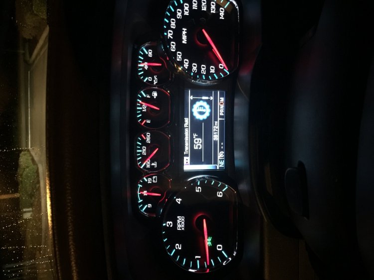

Long time guest but my first time posting.  I bought a used 2015 Silverado 6.2l High Country with 33,000 miles on it back in March of this year. I started noticing that my trans temp rarely gets above 130-140 degrees.  Actually this morning I noticed that it was 80* outside when I started my truck but my transmission temp was only 67*.  Im not sure if it relates to my vibration I get randomly.  My truck will out of the blue with out correlation to speed or in v8 or v4 mode just randomly vibrate until I give it gas or back off.

his trans temp is 59 degrees on an 80 degree day
a trans cooler wouldn't change the temp unless the trans thermostat was changed

In the morning when it was 80° outside, did it drop below 67° at night? Have you considered that there may be an issue with the temperature sensor that is causing and inaccurate, lower temperature reading?
