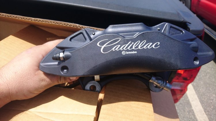

Oh ok, I think those are the rotors that the Silverado SS guys use with the Z06 calipers.
If so. Let me knowabout your extra calipers. i may be interested
I will, just gotta find out how to make them work, if not I'll have to sell them to buy the Z06 Calipers.  lol
Just front or front and rear?
Just fronts,  they are the take off parts from factory 6 piston upgrades
Ahh my ocd id need front and rear
I have 3 pairs so it would be nice If I could get them to work on both axles.
Keep me in the loop
I wouldn't even try to use the front calipers on the rear.  They aren't designed for a rotor that thin and the piston sizes are likely way too large--which could result in locking up the rear brakes before the fronts are doing much, increasing stopping distances.
