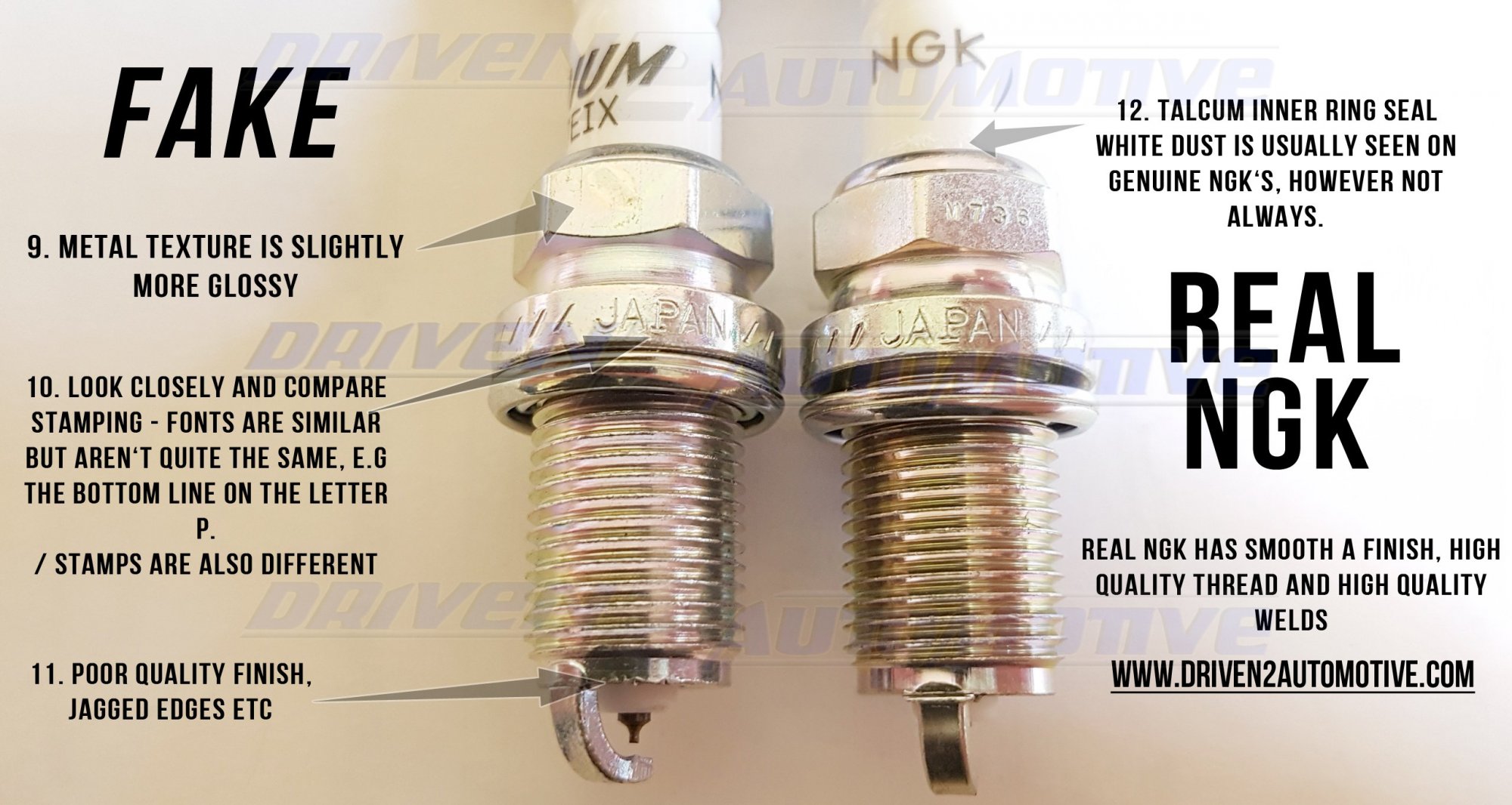

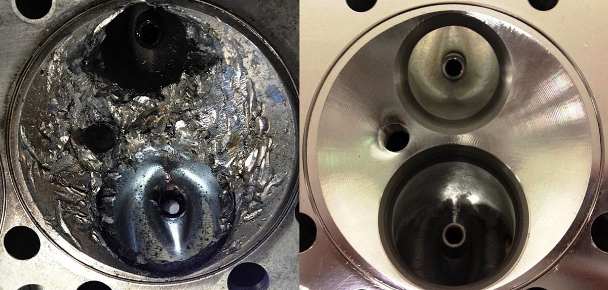

That's true. The cable I bought was a genuine ACDelco part, but you do have to watch out for Chinese counterfeit parts, especially when you buy online. Amazon generally keeps an eye out for fake knock off parts, but not all retailers do.  I got a batch of counterfeit spark plugs on eBay once. The seller promptly agreed to a full refund and payed the return shipping as well.
The counterfeiter spark plugs fall apart and can damage your engine.
