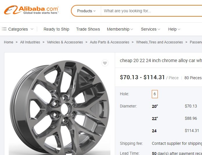

Just a follow up to this Replica Wheel discussion. I really want some 22" GM factory chrome wheels but cannot find the CV92 pattern im looking for. That said I looked into the aftermarket only to find that just about every wheel made comes out of China. But the replica GM wheels I'm seeing for sale all appear to be these gravity cast units with no certifications. Tire Rack is now selling these for $500 per wheel while describing them as gravity cast wheels. I doubt they have the JWL certification (a raised casting) on the back.
Here are the most common Certifications. JWL is typical for truck wheels and is found on factory GM wheels.
SAE (Society of Automotive Engineers)
TÜV (German regulatory agency)
ISO (International Standards Organization)
JWL (Japan Light Alloy Wheel Standard, VIA conducts the tests)
DOT (Unfortunately here in the USA a DOT wheel means nothing other than its dimensionally correct. No testing for quality or material integrity.)
Below are these no-certification Chinese replica wheels that sell on Alibaba for around $20-$100 each depending on qty. and list the application as "suitable for trailers." How about someone make a quality replica GM wheel with certifications.
