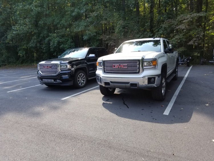

I'm running a Zone 2" Level and a Zone 1.5" Body Lift with 285/60R20 tires.  I had the tires with just the Level Kit and it was fine. I wanted some additional height so I added the Body Lift.  I also have the 5100 shocks but they are on the stock height setting as you don't want to stack lifting accessories.
The 5100's ride so much better than the Rancho shocks that come on the Z71.
Mine is the white one next to a stock height Denali.
