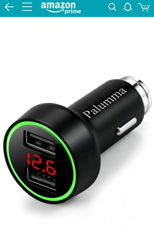

I use one of these digital volt guages in my 17’ when towing / camping with my travel trailer. I know its not 100% accurate because its in the cigarette lighter but its handy to see where the charging system is at after a few days of camping.
I believe a fully charged battery should be 12.6-12.7 v after it has stablilized from charging.  My recollection is 12.2v is about a half charge or less.  Driving voltage of the electrical system should be at least 13.7v. and will fluctuate with charging cycles.  My recent experience with my 14 Camaro and 14 Truck was that the batteries went south at the 2 - 3 year mark in both.  Same battery spec for both.  Some batteries I've had go twice as long as these.  But it seems common for these OEM batteries to fail around 2 years these days.  Everyone wants to be the guy that can come on these forums and say they had a battery go many years.  But that just hasn't happened to me in a long time.  I have had better luck with premium batteries going longer.  I think the 2 DieHard batteries I put in my 2008 truck in 2010 lasted with my brother until a couple years or so ago.
