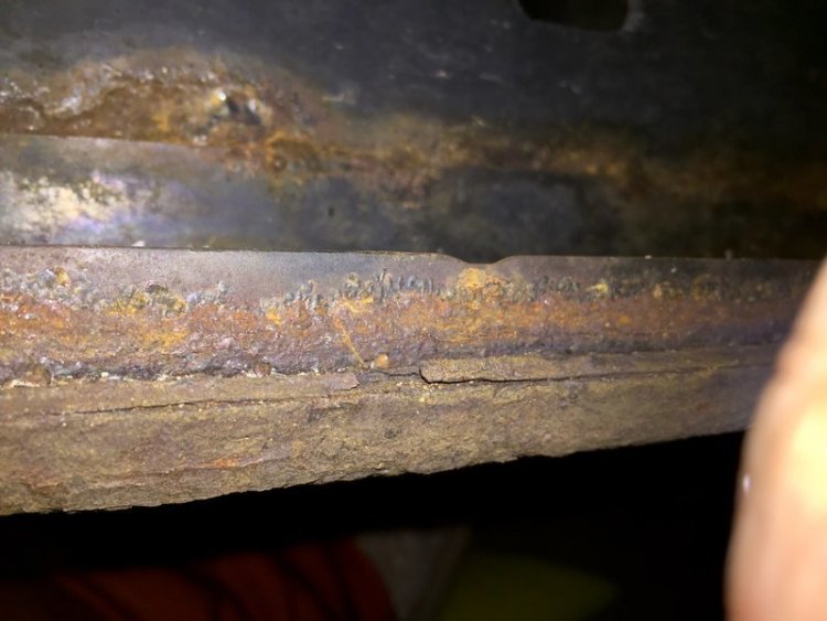

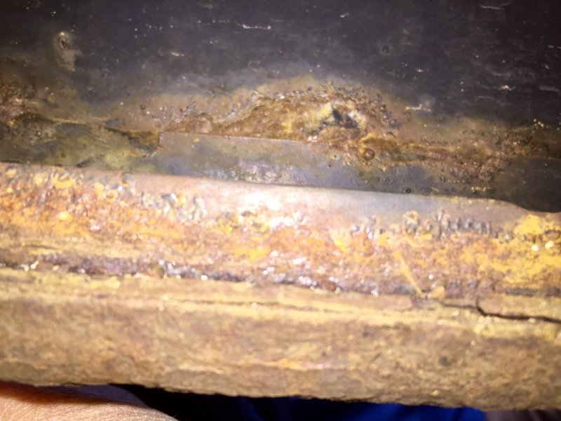

BTW, here's a 2013 Tacoma with the early stages of cancerous Toyota rot. Within a year or two, the frame will have rust perforation. As with most Tacoma (or Tundra) owners that have had frame rust, Toyota frames rust from the inside out (coinciding with the welds rusting) due to the way they're designed. The front section has huge openings that collect organic matter, dirt, and road salt thrown by the tires. The center frame rails are closed-C sections that collection the same debris. The front leaf spring mounts also catch debris that speed up corrosion (most Tacomas with advanced frame rot have major issues with the front leaf mounts). It's a poorly designed frame that only accelerates rust rot,  made worse by the awful frame coating they used for decades.
https://www.tacomaworld.com/threads/2013-tacoma-frame-rust.567973/
