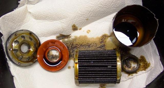

Thanks! I had the induction service done at the last oil change by my dealer. It really sounds like a pinging noise and I suspected it was possibly something with the fuel. I’ll try a higher octane next time I fill up and see if that doesn’t help. I’m also going to change the oil over the weekend myself and cut the filter open. I usually have the dealer do the services, but I want to take an oil sample and see inside the filter this time.
