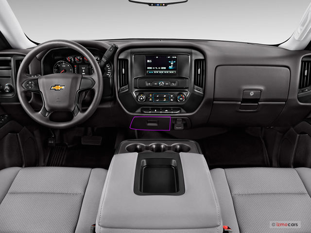

I don't know how large it is but you could look at creating a plate out of some sort of plastic and putting it in the bin on the center dash if your truck doesn't have the center console (in pink below).
Outside that I'd think that your only other option is the console under the armrest. Only other option I can think of would be to use smaller switches and maybe you could get 4 above the 4x4/light selector (left of steering wheel).
Unfortunately I do have a center console. I did some digging, and pulled my console apart last night. I’m going to build a box for the board and put it in the console. I actually use the storage so I can’t put it under the armrest/in the box. I think my best bet is the cup holder area. If I put it in the little cubby area between the cup holder and the outlets on the dash/front of the whole console, I don’t have room for wiring. I believe the sub from the bose system is right underneath that. I don’t use the cup holder that often and have two on the door if I need them. Also gives me the option of hiding my drilling through the bottom of the console if I ever want to take it all out. Cup holder clips back in and my hole is hidden.

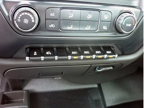

There is a factory available light switch panel from GM, adds 4 AUX switches to the dash. But only for trucks with only traction control & cargo lamp switches.
Do you have a link for these? Thanks.
There’s the part number listed in this thread. It’s kinda involved to make these work at least the way I understand it as I believe these are all negative/ground switches. I lost interest quick so don’t quote me on that.

I also looked into that switch panel. I love the idea. GM upfitter offers them as an upgrade. It is basically a WT option but not factory available on any other truck. You need to upgrade the fuse block, because the standard block does not have wiring/fuses for the other switch locations. Then there is the wiring between the switch and the fuse. This project quickly got over my head so I forgot about it.
I've been following the topic on those switches as I'd like to eventually a lightbar, rear lights, and maybe rock lights and underbody for the fun of it. Been having a hard time following it as well since there are multiple conversations going on at once related to it. I need to write down and follow one of the diagrams I guess. Also never done anything external for wiring and want to add a second battery to run the aux stuff off so it's gonna be quite the process it seems.
I would love to have that setup on the toggles, but I don’t want to tear the whole thing apart, and the electrical setup seems crazy. I will definitely building a box for the switch board and housing it in the cup holder location. This will make it look as stock as possible while still being clean wiring wise
