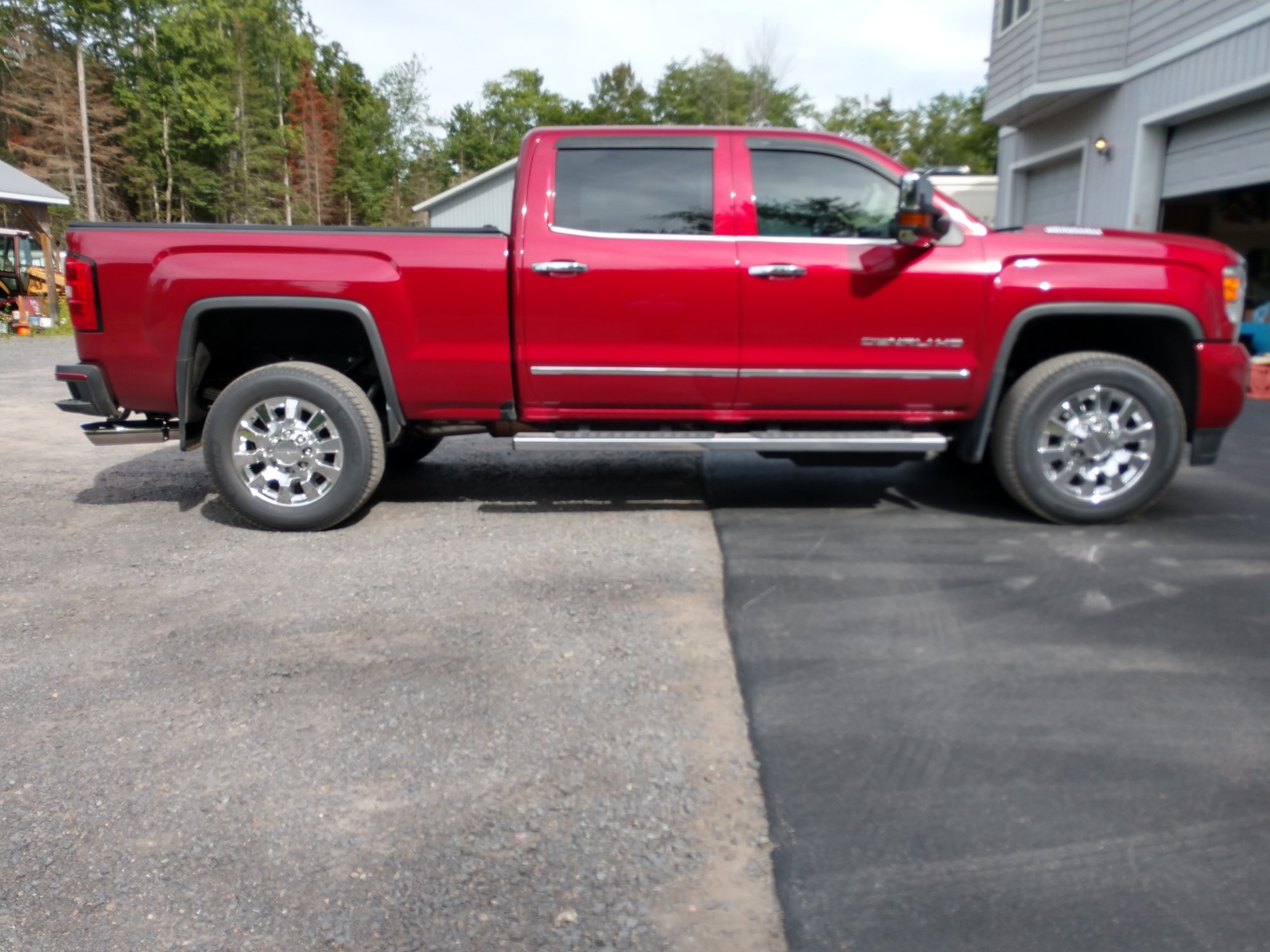

i have 275/65/20 STT Pros. Love them. Stock truck no lift/level. Stock wheels.
I run 285/60-20 Michelin Defenders.
No mods of any sort to make them fit, speedo is only 1mph different, and they gave me the added load I was looking for.
3190lbs. compared to 3700lbs, just what I needed for hauling my 5th wheel
