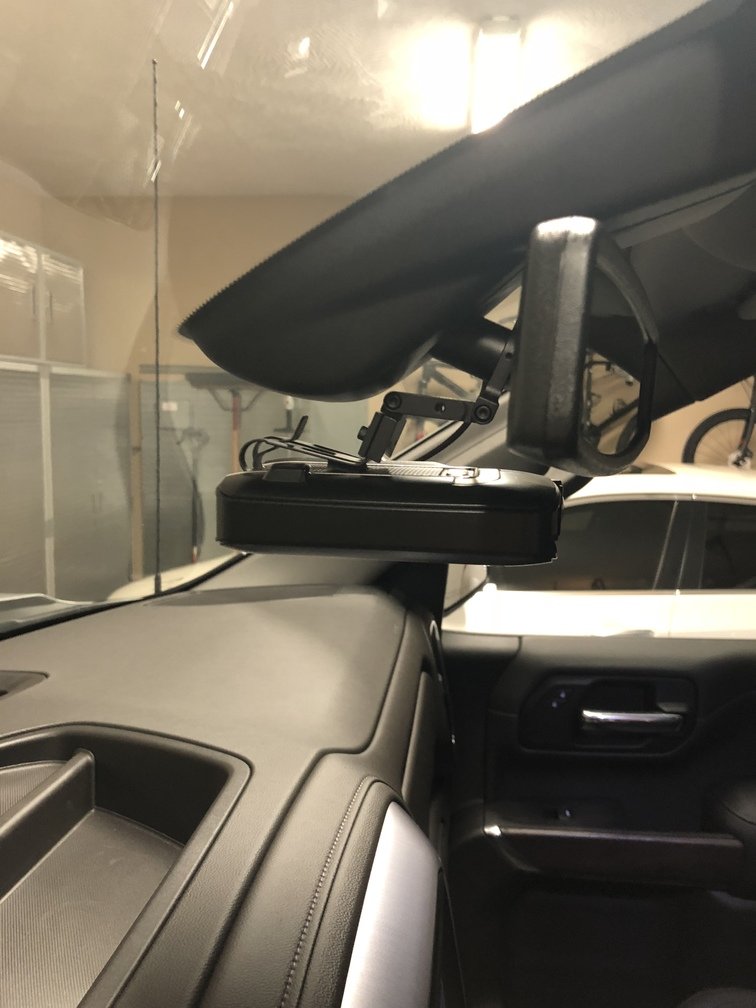

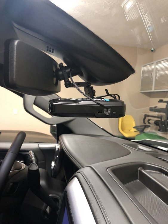

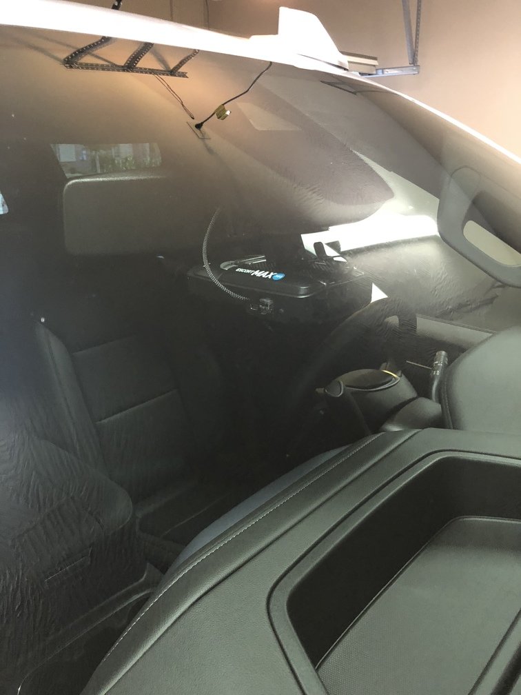

I wanted to post some pictures of my blendmount install and wiretap install for those of you that may have questions.
I used the blendmount for a 2018 GMC Sierra and the wiretap for the same.  The plastic mirror shroud is easy to get into.  Just pull down on the center section with the air louvers with a pry tool.  Then the outer area you can just slowly move it around the wires even with the windshield.  Don't pull it down, pull it such that it is equidistant to the windshield.
The wiretap has a red and black wire on it as expected... so I plugged those into the wiring harness on the passenger side of the mirror -- red to red and black to black.  It turns off and on with the truck.

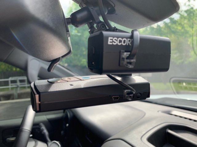

By any chance do you have the camera mirror option or has anyone done this yet with one? I want to order the mount and harness for my V1 but there’s no option on their site for the camera mirror. My plastic thing above the mirror looks the same as the one in the pics.
  • 2 months later...
I'm a new Sierra truck owner. I have the Rear Camera mirror in my vehicle. In order to tap into the power, does the little grill cover in the first picture of this thread just pop out by pulling, or do I have to have a pry tool and insert from the side to remove? Any guidance would be appreciated, thanks.
I used a pry tool, was pretty tuff to get un-clipped.
Here you go:  https://store.blendmount.com/escort-m1-dashcam-c14345.aspx
I installed my Uniden R3 with the Blendmount mount. It went in very straightforward and looks just like the OP's pictures.
