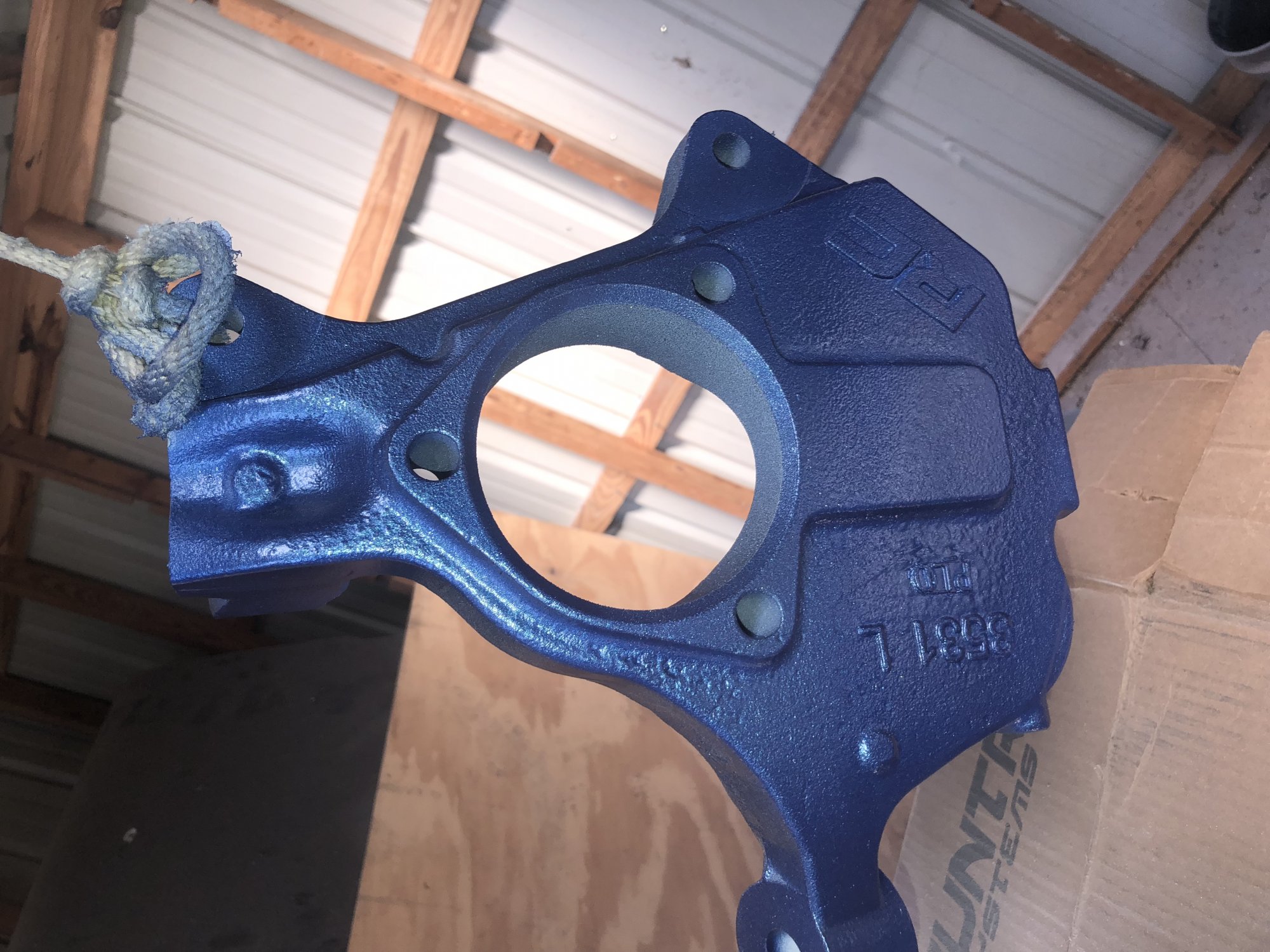

Reason i added the spindles was because the alignment guy told me he wouldn’t align the truck without the spindles because they are “the right thing” and wouldnt touch it if i cut the droop stops
my control arms werent touching my coil before the spindles now they are
these are the spindles
