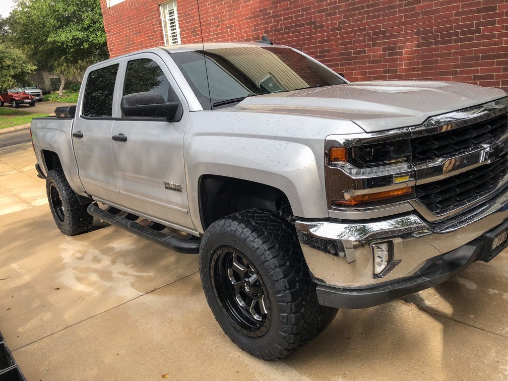

Well... there is ALWAYS something that I didn't know!  And this would be it!   the 20x10 wheels stick out in the front like a pissed off high school teenager and like most adults, I do NOT like it!
I'm out 2 full inches beyond the fender.  No good no good!   I do not like it at all.
First solution is to change the two front wheels to 20x9 +1 which would tuck it back up under there an inch and would match the back.  I"m good with the back but the front looks ridiculous to me as described.

Why don’t you just add another 1 3/4” Bora spacer in the rear just to compensate?

Because I do not like the 2" outside the front fenders.  It looks ridiculous to me!  Ughhh... I'm very frustrated with this and hopefully can get it corrected with a 9" wheel.

Sorry you’re going through all this, it’s not going to matter much because you’ve replaced your factory knuckles with new ones that push your wheel tire setup out. You can’t just buy two 9” wheels up front first of all how would you rotate. You’re stuck with it but when served lemons make lemonade. Add painted to match side fenders and bora spacers and you’ll be all good.

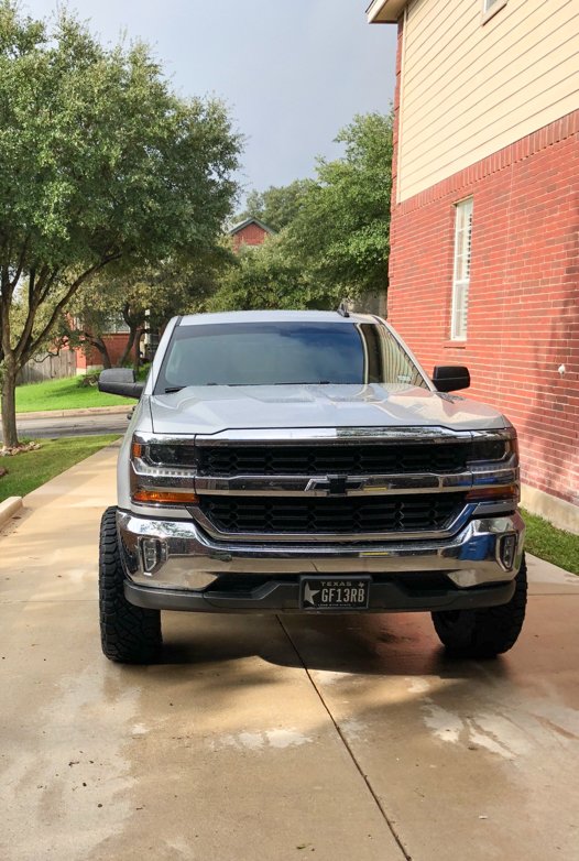

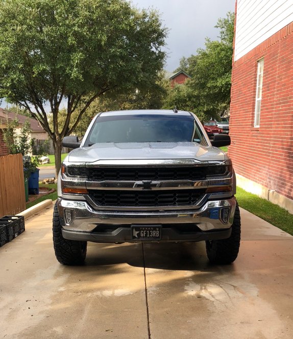

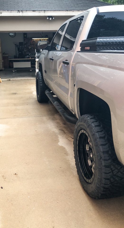

Thank you all for your support....  As time goes on and I continue to see it, it's getting better (a LITTLE).  I still don't like it outside THAT much.  Talked to a few more peeps and they say the 9" wheel will bring it in some just by default due to the less of an in in the wheel that won't be there.    I don't mind it sticking out and like the aggressive stance with that, but 2 FULL inches out is just that "bit" too much for me.   I'll know more options Monday for sure.
Here is where we are today! :)  Thanks again for your support TXGreek and I WILL be doing the flares regardless! ;) good call!

You’re very welcome, I’m a way, you’re sorta experiencing what I’ve been contemplating on lift. Good looking truck, I fully understand what you’re saying. If you can try and get them to swap out just the wheels for 9” but, you’re still going to have the front wheels stick out more than the rears being the front knuckles were replaced. The Bora spacers are the best and absolutely safe being they’re bolted into your existing studs and having their own bolts come out where your rear wheels will bolt onto. Relax, you’re making this a fun build. Btw, hows the ride quality compared to before?
