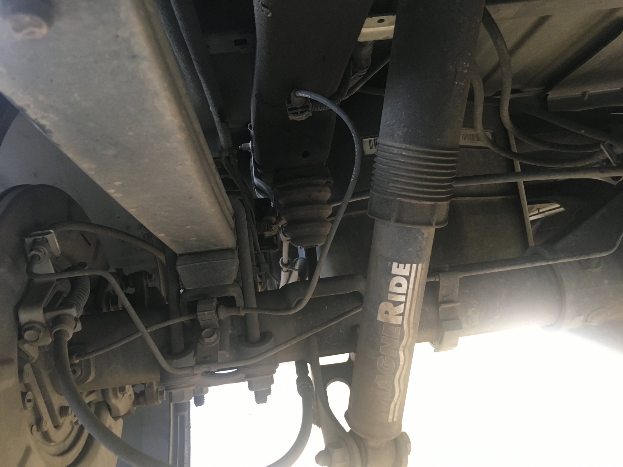

Jerry Lee Posted October 25, 2018 Author Posted October 25, 2018 Thanks Rukus. Is your pickup the same as mine with Magneride? I’m not saying the shocks are the problem but don’t know. The tongue weight on the camper is the same now as it was when I pulled it with the Chevy. I don’t know how much it is but guessing 650 lbs at most. I got under the truck and looked and even without the WD bars attached the back of the truck is not sitting low! It feels to me like maybe the shocks are locking up when the trailer is attached. I wonder if there’s a way to disconnect the Magneride just to see if that could be the problem? Does your air bags bolt to the top of the axle under the bumper stop? Do you raise the back of your pickup higher than normal? I attached a picture of my axle with the trailer attached.

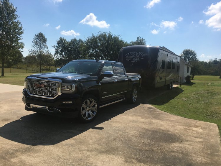

Jerry Lee Posted October 25, 2018 Author Posted October 25, 2018 Thank you for your reply and help. My 17 Denali is like yours and has Bridgestone P285/45/R22 tires. The Chevy also had 22” but I don’t remember the brand. Before the Chevy, I had a 2014 Yukon XL 5.3 and it rode really well pulling this same camper but the 5.3 was too weak. With the WD set at 2 links on the chains it feels like the backend is bottoming out and with 3 or 4 links it feels like the back of my seat is hitting me in the back like a large bob truck I drove one time in the past! The Chevy LTZ rode much much better with the camper but not as well as this Denali without the camper. This Denali rides almost like a car and that’s what I wanted. Plus, I love the lane assist! I don’t think the brake assist works, or I’ve never had it do anything when I approach the rear of a car at a red light. It’s turned on the best I can tell. I plan to start another post about that later. I’ve attached a picture of the truck and trailer. It appears the back of the truck is low but it had 4” between the top of the axle and rubber bump stop.

Rukus Posted October 27, 2018 Posted October 27, 2018 No, I do not have the Mag ride system. However, I know several that do and none have really liked the set up while towing. Part of this reason I was turned on by the assist set up was their recommendations. It seems to me that your springs are weak. The shocks should not be offsetting the load that much.
Pearl2017 Posted October 27, 2018 Posted October 27, 2018 The WDH is not for setting the the ride height or smoothing out the ride. Its job is to virtually shift some weight forward of the rear bumper over the rear axle. Adding too much WDH is dangerous, if you lift off the throttle abruptly and hit the brakes the rear wheels can unload and jackknife more easily. Your answer is to set the WDH correctly and if the suspension sags install some air bags to get ride height back and assist the springs to carry the load. I tried Sumo springs first and didn't like the ride and have the airlift now are way better ride.
Jerry Lee Posted October 27, 2018 Author Posted October 27, 2018 Thanks for the replies. After more observation I have noticed the rear of the truck is not bottoming out because there are no signs where the rubber bump stop has hit the top of the axle flange. Evidently the rear springs are either too stiff or the mag shocks are trying to stop any bounce but I can’t figure out which. Any suggestions on how to diagnose the problem? On the next trip I will adjust the WDH back to normal. It didn’t really help to adjust it up higher anyway and I sure don’t want to increase odds of an accident! Winter time is coming here in MS and I may wait until spring to do anything but this problem is keeping me awake at night trying to figure out what to do. I’m thinking of removing the shocks and testing them to be sure they will travel the full stroke distance and if so see if I can disconnect them for a test. If the shocks are not the problem I will probably trade it for something else even though I know I will lose a bundle of dollars! I just can’t take another long trip with the camper! I love the Denali other than this.
