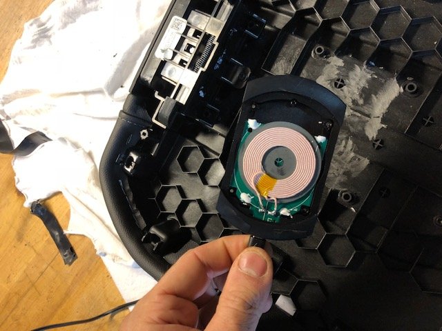

Success !!!...went with the DIY cheaper solution. bought a $20 Qi charger...took that apart to slim it down, took the lid apart to get to the inside, dremeled out some plastic to get a good fit, secured that with some hot glue and ran the cable neatly to the usb port inside the center storage. im sure there are other solutions for that but suits my needs so no need to hard wire anything right now. aside from the wire, which takes a sec to actually notice...looks completely stock.
Do you have any pics of the process or finished product?
