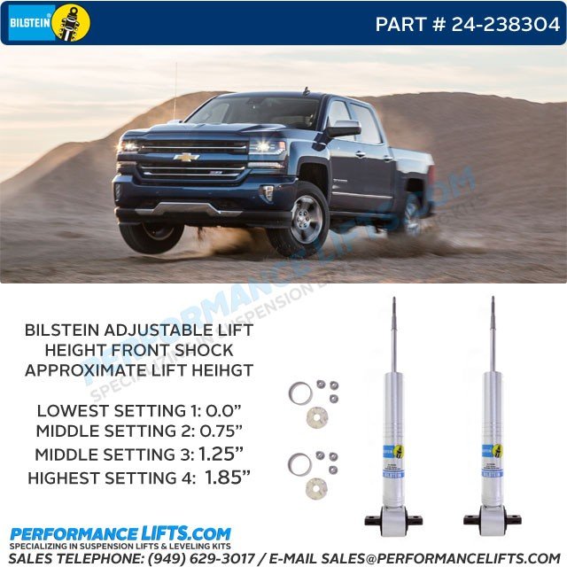

Shocks are on the way. Got them on all 4 corners. Two more questions:
1) The rear shocks are labeled "0-1 in" lift, but aren't adjustable to my understanding. Will these lift the rear from the stock Ranchos?
2) Does anyone know the height measurements for each setting? I know bottom is stock and top is 1.85 in. What are the 2nd and 3rd ring settings? Trying to decide which one to choose. I don't need to level it, just want best ride quality with a little more clearance. However, if the rears raise it an inch, that may sway my decision so it doesn't look even more raked than now.
Thanks!

The rear shocks are longer, but they do not change ride height at all. You'd have to change the rear blocks or springs to do that.
Most here get 2” or 2.25” on top notch. I put mine on the second from top or 3rd from bottom and for 1.75 - 1.8” lift. I left the stock block in the rear and put 5100’s in. I still have 1.5” - 2” rake from front to rear which I like. You need an alignment after installing as your toe will be out of spec and will cause excessive tire wear even though my truck seemed to drive fine.
