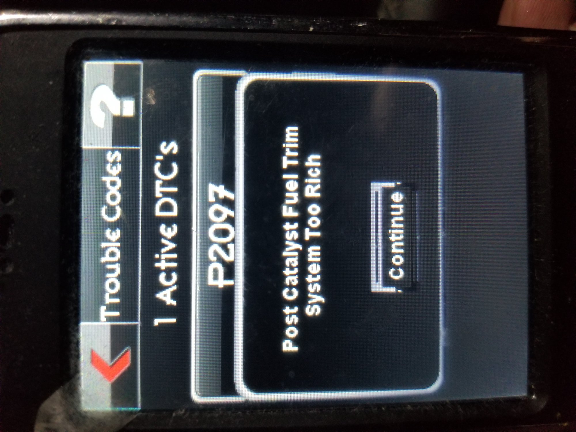

So I had a check engine light popup a week ago and dealer replaced all 4 banks of sensors and the catalytic converter, totalling over $1,500 in repairs (covered by extended warranty). Truck has almost 70k miles and the extended warranty is good for another year and/or 5k miles.

That is bs there are 2 Banks and 4 sensors. Up stream and down stream. Checking the codes should show down stream issues if cats where bad. I would guess something larger in the engine commanding fuel trims.
First code was P2097...

And there it is bit fuel doesn't magically show up in the cats. The pcm is commanding it. So real question is why. On these trucks there are about a thousand reasons. As so many sensors can chand the fuel,idle, and air. I would request a full sel print out. It can be two pages. It will show history as well. Then I think I would pay the low cost of a good independent shop hooking up a scan tool and going through all the systems. He may come back with a issue. Then you can still have GM fix it.

Question. Could a bad pre cat O2 sensor trick the ECM for more fuel and be pickup up by a functional post cat sensor?
Yes but that would throw a code as the truck would be confused to why one bank is lean as it cant add fuel to one bank like that. So you would need 2 bad up stream o2,baro, iat,engine temp ect.. to command fuel trim. All things that if to far out of spec should throw code. But there are solf codes,dont set off light. So a complete history report is the only way to attempt to find the issue.
Hell maybe a miss fire or bad injector. As I said could be a thousand things even if all physical parts are good.
