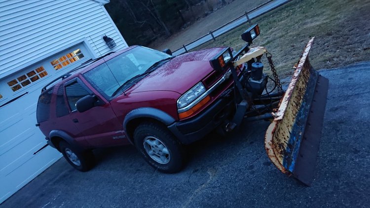

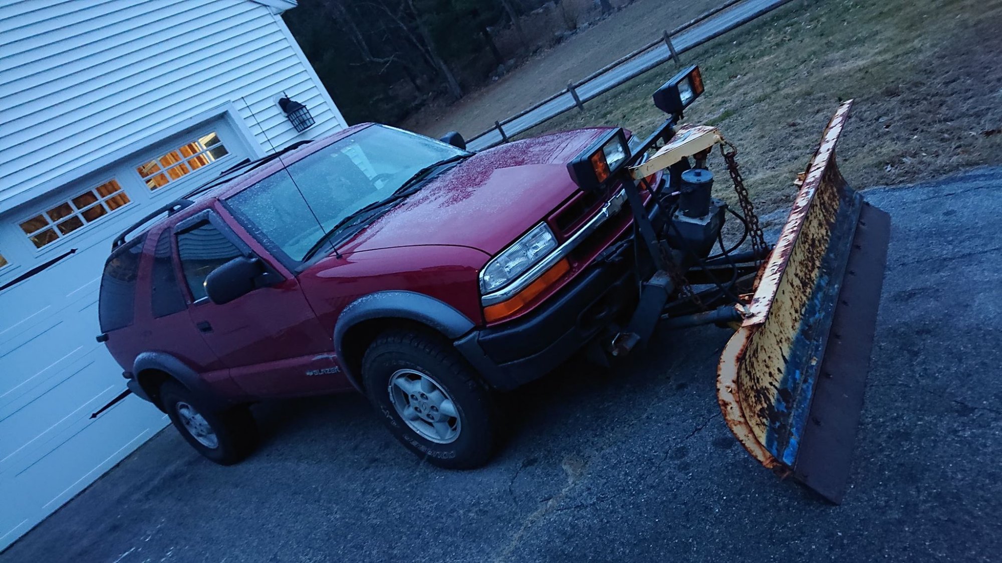

I plow with a 2 door Blazer.  Had a 4 door before this one. I use a 6'9'' fisher plow and it hasn't let me down yet, even in 18+ inches of snow.  If This POS Blazer can do it, your 1500 can do it easy.
