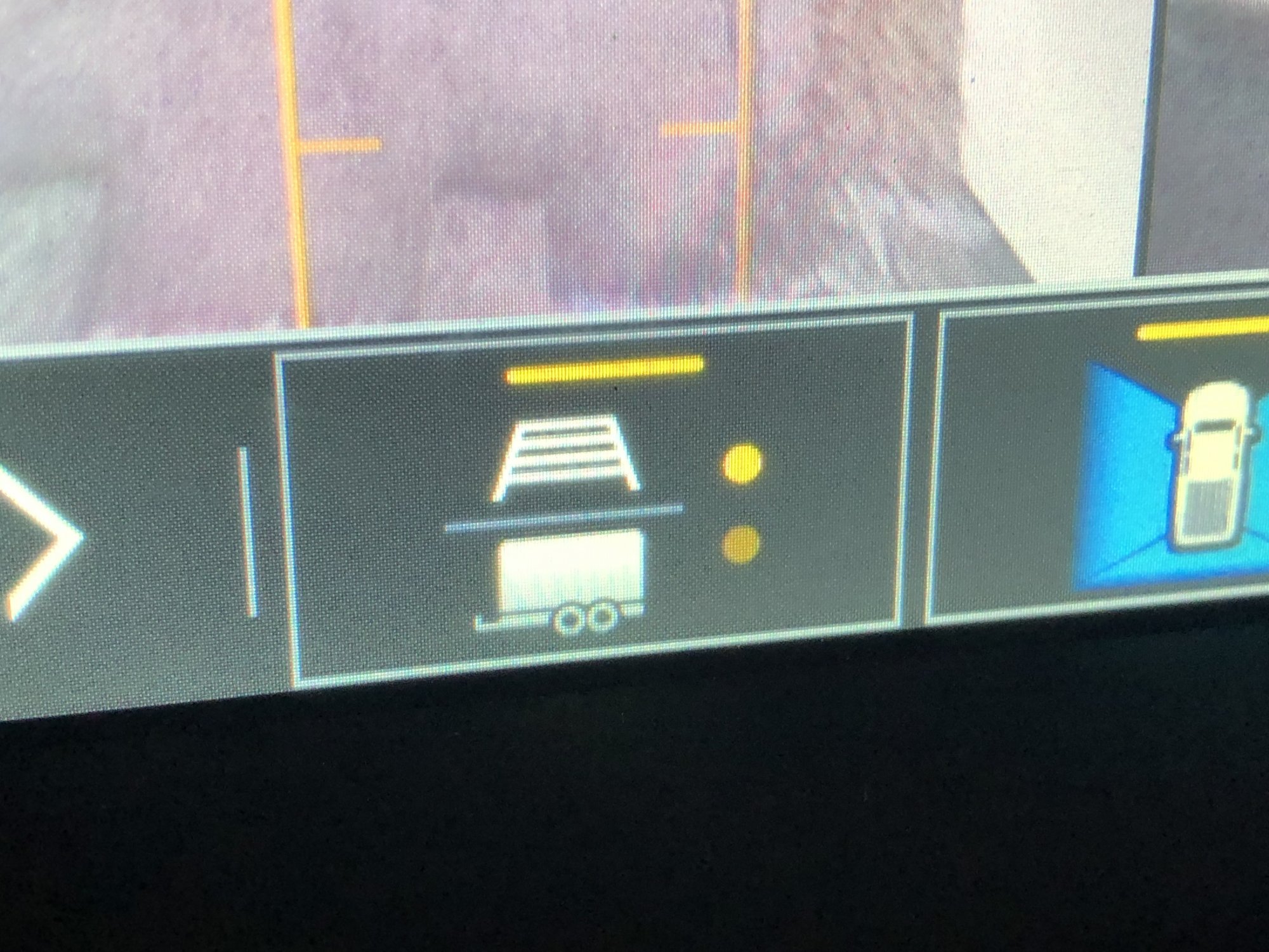

This is currently happening with my truck.  The guidelines were once there, but are no longer selectable via the button.  The graphic on the button changes to show it should be on, but no guidelines; not in the front, the back, or even with the hitch guide.  Called GM and they didnt know.  Took the truck to the dealer, and they also didnt know.  They said they even tried to re-load the software.  I also have a hour glass symbol in the upper left corner that is persistent whenever in any camera view.  All of the cameras work, just no longer have the guidelines.IMG_2993.jpg.4f7c1a7df3c84b82f7ae15f44b262b27.jpg
What is your Sofware Build Version? [L206, V507 or V509 [Latest]]. The hour glass indicates the system is busy which I have not seen at all on these units. Ask the dealership if they re-loaded the Radio software or the Build Version. I went to the dealership to get my V509 installed since Onstar said they could not do it for some reason. The dealership loaded some latest Radio software but it did not change my Build Version. You might need a complete reload or try returning the system to Factory Defaults via the Settings Icon.
Edited by Rocz3cqg
It's V509.  The hour glass has been there since last Saturday.  Got the truck last Friday.  I'm almost positive I saw V507 last Saturday, so no change in the status.  Not sure what exactly the dealership loaded, their words were that they "re-loaded everything."  Also, I restored everything to factory default which had no effect.

I agree, pushing that button should cycle through the different options for displaying the guidelines.  Refer to my original post; in the picture, you can see that I have the guideline selected, like you, but I have no guidelines showing in the back-up view (doesnt work in the front either.)  They were there, but since that hour-glass is there, no guidelines.  Truck has been in the shop since Monday for the second time, I just have to wait and see what they come up with.

Did you ever get this resolved?  I have the same issue with the hourglass and no parking lines.
