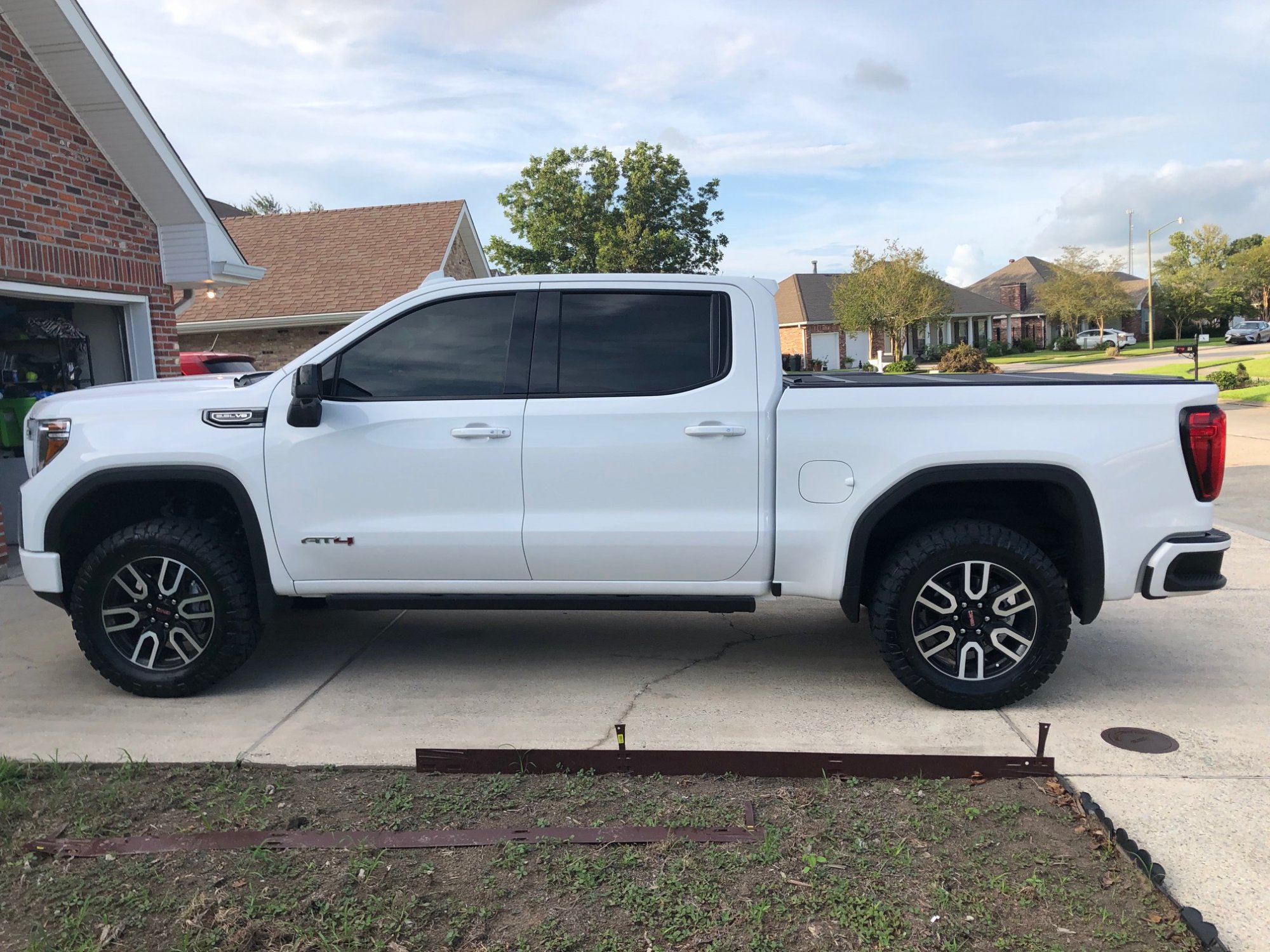

Following up on my earlier question about using an AT4 front strut assembly to lift a non AT4 4x4 SLT truck...I have done it and here are the results.
Front suspension - stock AT4 strut with 3/8” aluminum spacers under strut on the lower control arm. (I made these on a lathe)
Rear suspension - 2” block kit
Tires - Nitto Terra Grappler 285/65/20 on stock 20” wheels.
This set up has no rubbing at all and has not yet required me to do any trimming.

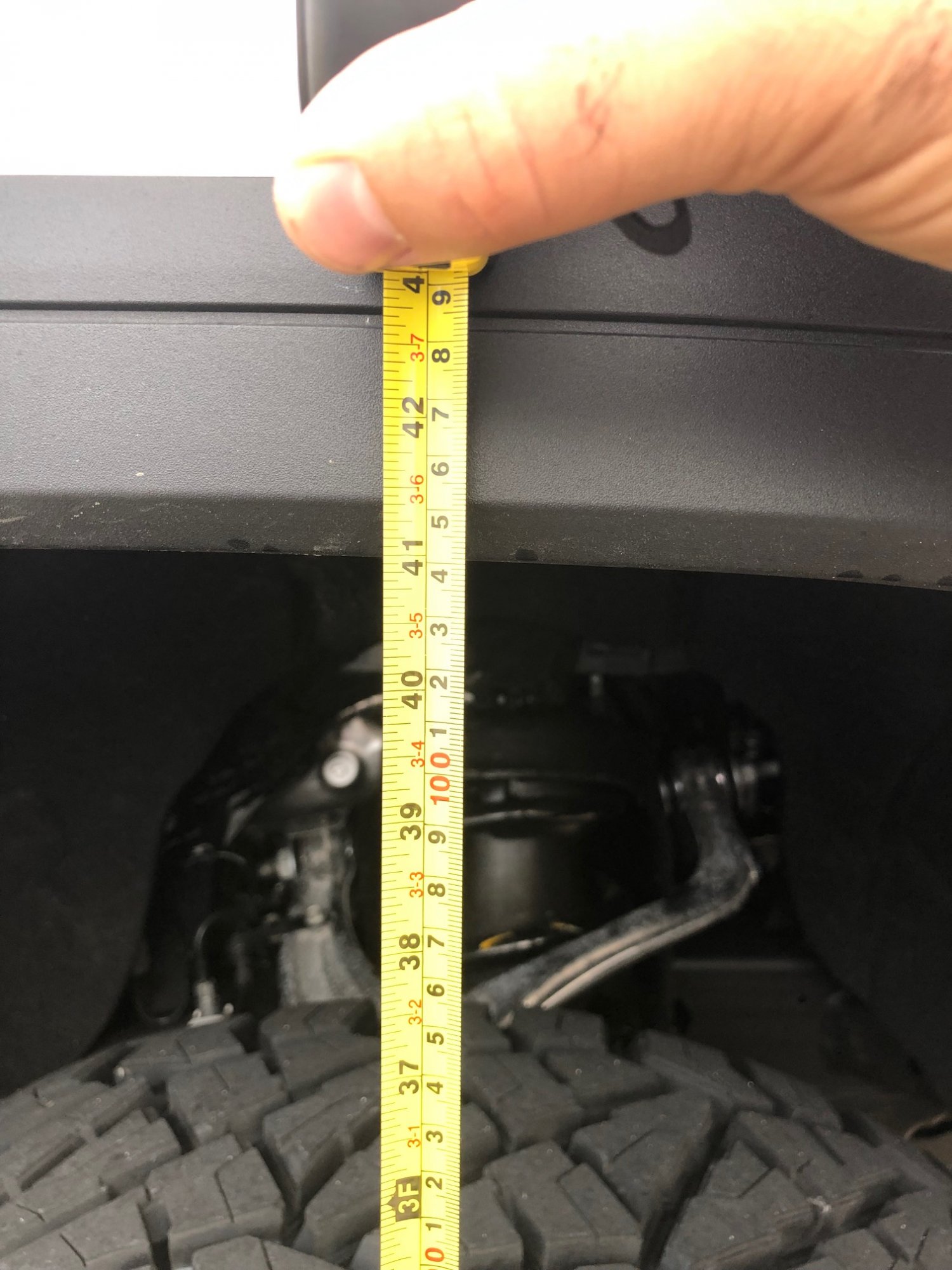

Anyone leveled a 19 sle with x31 if so what size leveling kit to make it level?
Did you measure your fender wells in the front and rear yet?
No not yet
Try that first. That’ll tell you what height you need to make it appear level or close to it.

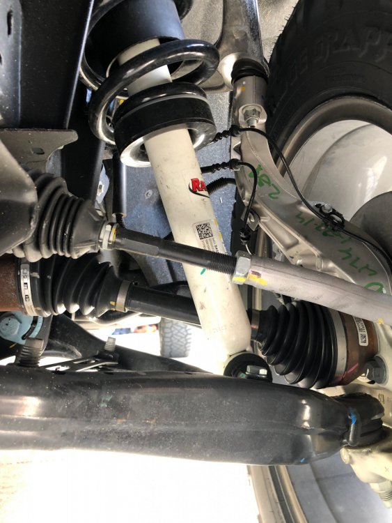

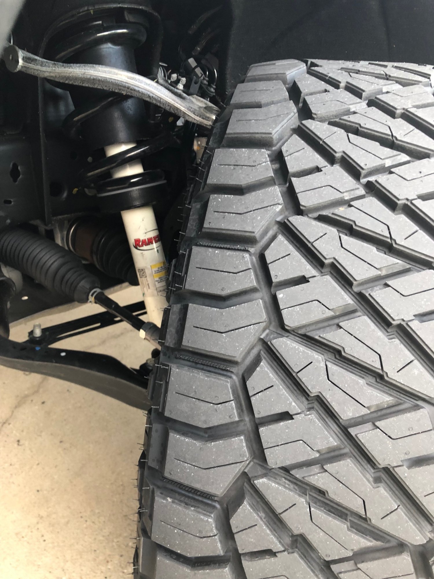

2" Rough County 1318 level
295/60R20 (34" x 11.7") Nitto Ridge Grapplers
The ride has not changed, and I am very impressed.  The truck is perfectly level, and I have no rubbing; it is very close on the upper control arm at full lock.  I am impressed with the CV and upper ball joint angles.
