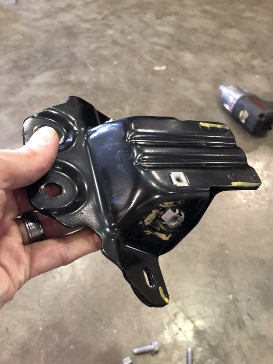

So I did a test fit today at the tire shop.  With the standard 2” lift on a Trail Boss and a 20x9 1 offset with a Ridge Grappler 305/55r20 it rubs on the mud flap behind the tire.  The rub starts at about the last inch of plastic.  We added the 1” lift and it really didn’t make any difference, still rubbed in same spot.  We removed the metal bracket behind the mud flap which allowed us to  push the mud flap back a little bit and we got the clearance we needed.  We never even tried the 20x10 -18 as no way that would have fit without more lift.

If you still have any rubbing on the back mudflap, you can remove this bracket behind it.  It’s only there to provide extra support for the mud flap, so not really needed. You have to remove mud flap first, then it’s just two screws to remove the bracket.  After removal, the mudflap sits back further and I had no issues with clearance.  But you may have more rubbing with the 20x10 -18.
