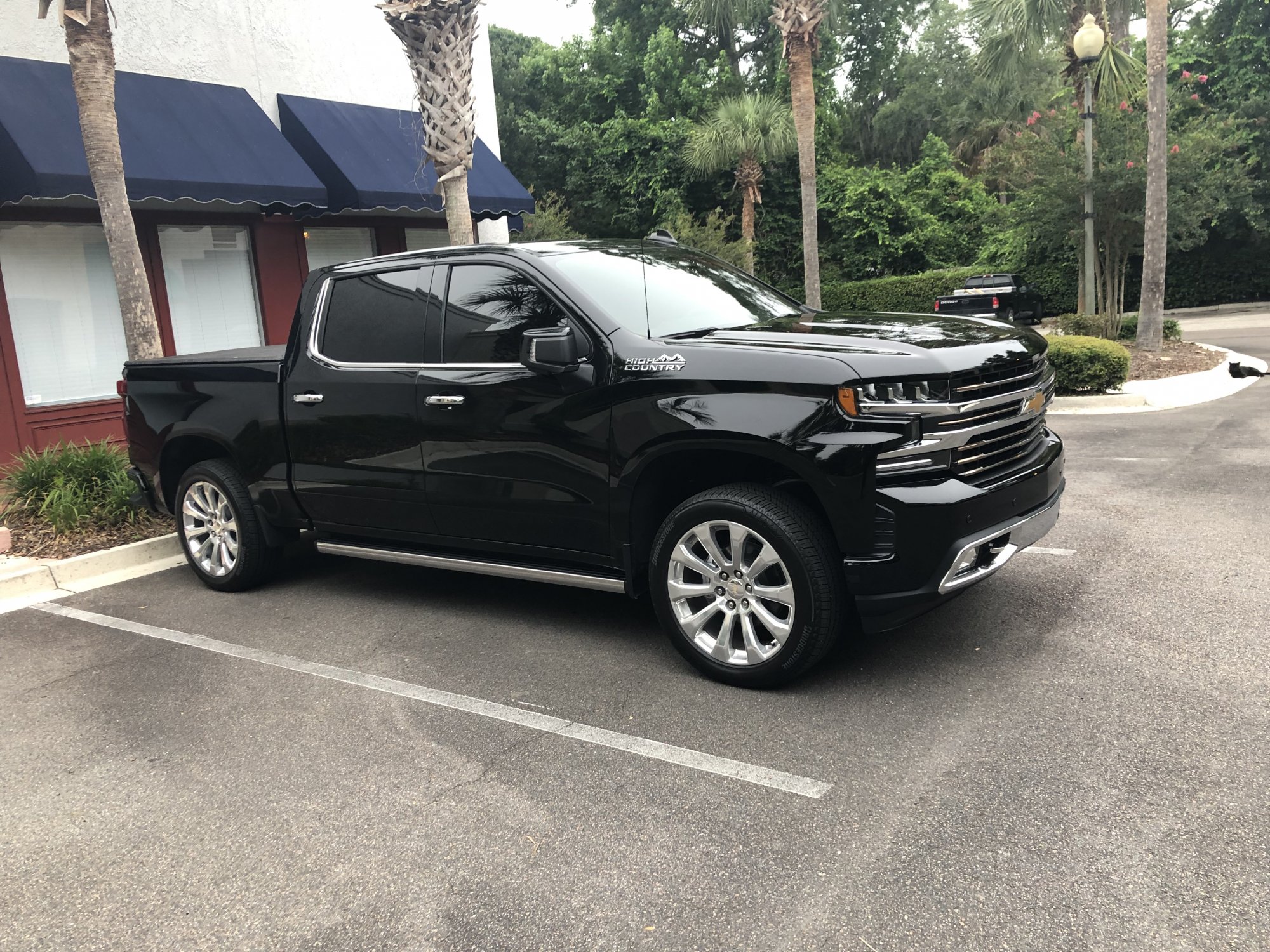

On 7/6/2019 at 9:18 PM, 19trailbossRic said:
2019 Silverado 1500 z71 trailboss custom Leveled with 1” rear drop shackle and installed airbags to improve ride and to stop porpoising while pulling a travel trailer.
Looks great.  The new Chevy's really wear any kind of lift very well.

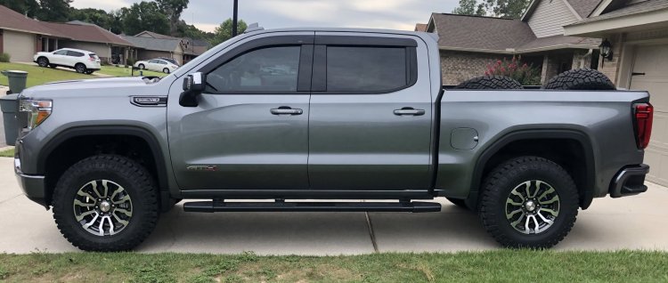

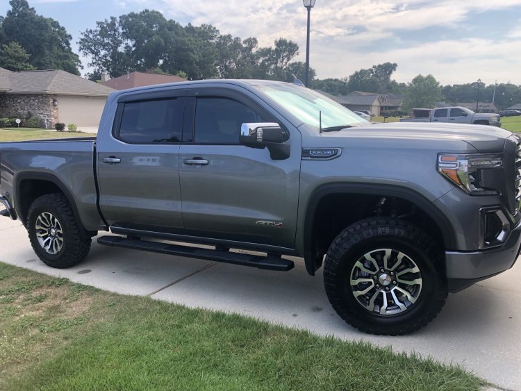

On 6/25/2019 at 12:54 PM, thsoccer3 said:
So far I only see 1 front level "approved" by the manufacturer for the AT4 -- Rough Country SKU: 1318.
My dealership has 3 leveled AT4s on the lot, and states the level kit will remain under factory warranty if installed and aligned by them for $875.  I am yet to verify this part number and take measurements of the trucks on their lot (I am away at work for a couple of weeks), but the parts department just stated they are using Pro Comp part number 63235, a 2.25" level.
Any thoughts?
I think its because chevy or gmc have a deal with pro comp or RC to do all their factory lifts, so chevy makes money on the lift and gets a better deal on parts from pro comp or RC....pro comp and RC get chevy and gmc business and free advertising....so its a win win.....its not that their lifts or levels are superior
same way chevy has a deal with rancho for trail bosses.....everyone knows ranchos aren't best shocks out
chevy and gmc make thousands extra for just a few hundred spent on kits, and rancho makes out having their stuff on all Z71 and TB truck
dealer knows that out of all kits installed only handful will come back for warranty, so their still way ahead profit wise.....they know based off previous years what the ratio will be so its just business...
its all about max profit, not best performance for customer.....
