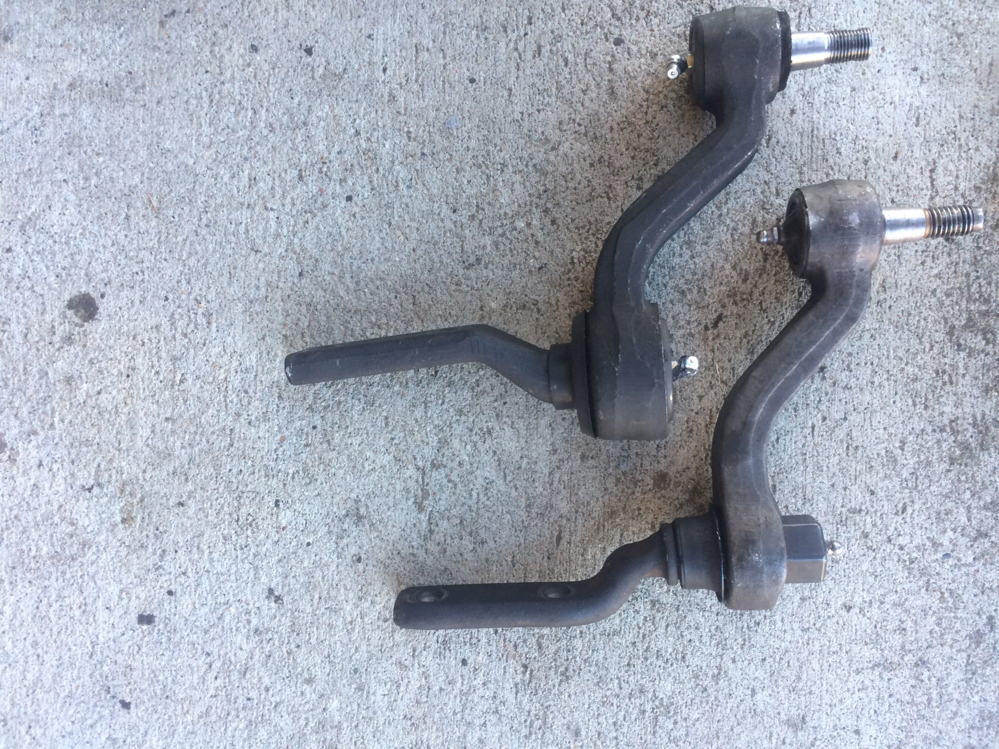

Thx for replies... Was in process of taking pictures\ observations, reviewing schematics noticed something odd.
Odd I thought because I specifically remember having old part in hand and reviewing schematic of the idler arm before install.
Well I did install it correctly, before I noriced I could not install tie rod with idler arm in first. Removed idler arm install tie rod to center Link, all good then installed idler arm backwards!!!!!!!
There it is, human error. During test drives it did just fine, it was only when a full turn in reverse with a slight dip incline it was that 1" of offset pivot of travel that allowed it to jam up.
Celebrating now....
Will post pics of install ( looks good imo) and pics of proper and improper install. As stated I scoured the internet for a similar situation, nothing. Therefore I feel obligated to own up to rushing the LAST item to bolt on and torque. In my defense\ stupidity the OEM version had a small hump of metal that would not allow you to install incorrectly. The aftermarket version was a flat bar seemingly bent around an actual frame mold. After frustrated by having to remove idler arm and therefore fit like a glove around the the frame with holes aligned perfectly.
Let my gaurd down\brainfart
Lesson, limit pre celebration beverages and any medicinals until completion.
Pic to come...
