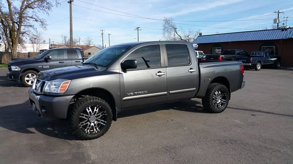

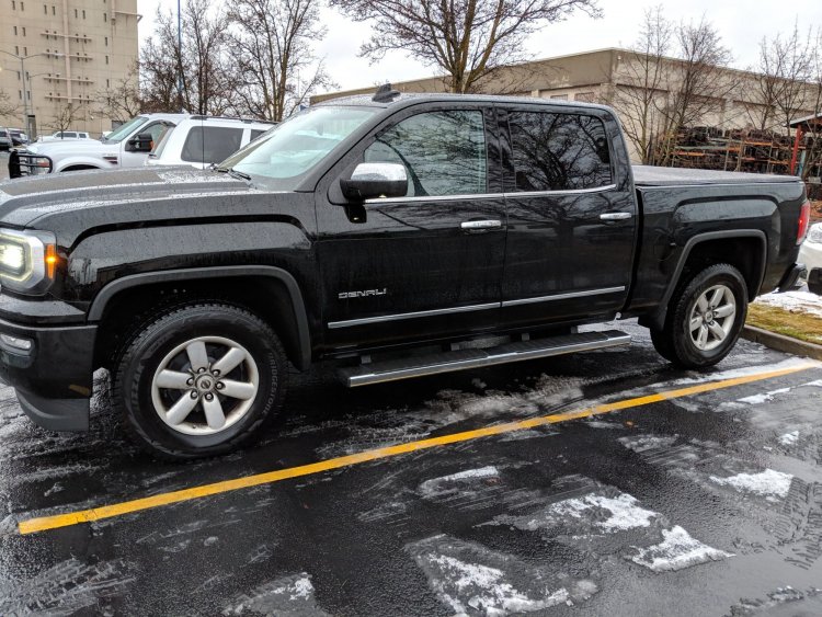

Doesn't look terrible I guess. They're actually 18"s (I had 17" steelie wheelies before). Not sure what to do with the NISSAN logo. But Blizzaks this morning with 3" of snow felt good. Here's the Titan. Had to take the snows off, put my 33"s back on, then put the snows on the Denali...
I've seen plain center caps on FleaBay. I just haven't gotten around to getting a set fo my old truck. Infiniti caps will work too. They have a logo on them, but it's better than having "Nissan" spelled out.
