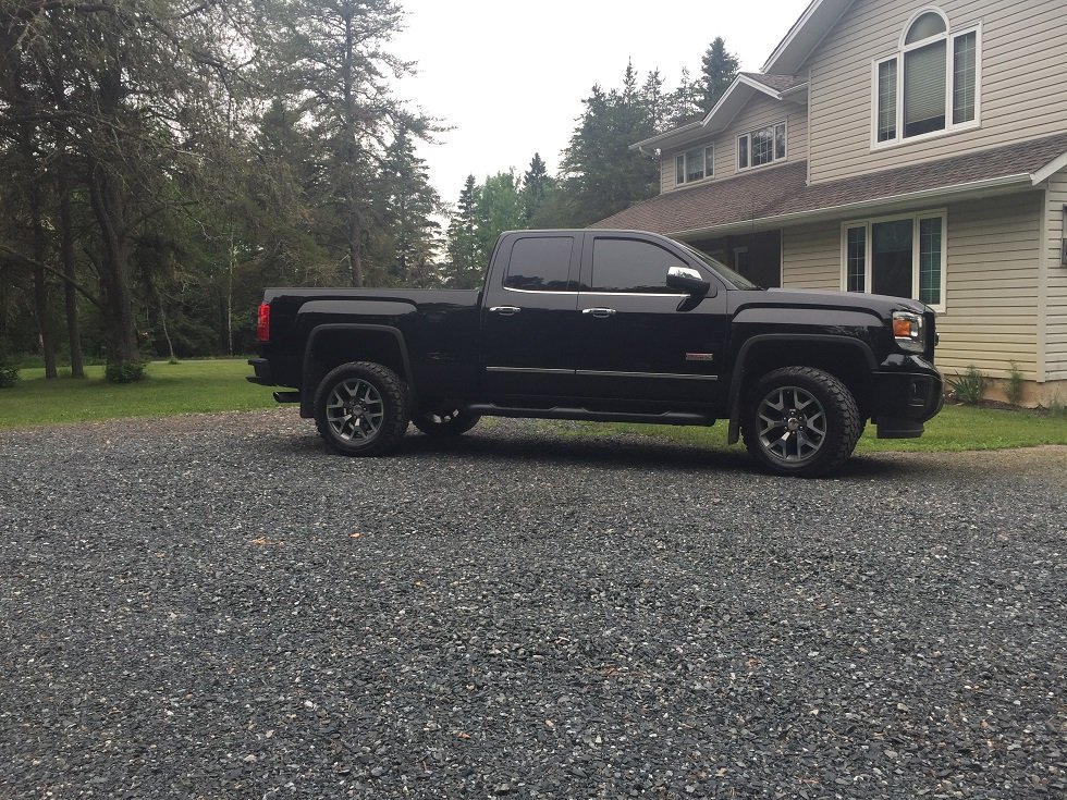

I have a 2.5” leveling top coil spacer and 2” blocks in the rear in place of the oem 1.25” and as previously stated it provides a just about a 3/4” rake. First i tried out the 1.5” blocks but it wasn’t enough the truck would still give a nose high appearance. ff4db9fbecbf761839a476d50a16f71b.jpg

I always put a block in the back because I load my truck from time to time. If you just do the front, the truck rides level when used as a car, but when you use it as a truck and load it up, its sacked out and looking at the sky, kind of counter-intuitive to a truck being made for hauling stuff. Mine is a 2.5 kit with a 2" steel block and shock extensions in the rear. I can clear a 33x12.5 R20. You can see how my truck sits with a load on it, and you can imagine how much worse it would be without that rear block.
As the other members said, 2.5 front and a 2” replacement block in the rear will give you just a slight rake. It makes for a good looking and functional truck.
If the op meant 2” additional in the rear then you’re lifting the entire truck and only bringing the nose up .5 inch in relation to the rear. Which is what guys do that want bigger tires and like the stock rake or they load the rear heavy or tow near max.
