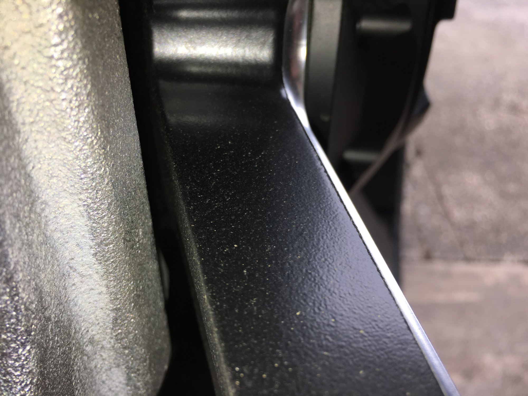

14 minutes ago, Codym8209 said:
Fuel contra
20x9/+1 offset/
A few wheel sites say these fit but they don’t without a 1/4” spacer and I only have about 2mm clearance between the caliper and the wheel.  The +19 offset would’ve fit great but oh well too late.
This is the caliper clearance
Edited by Codym8209
