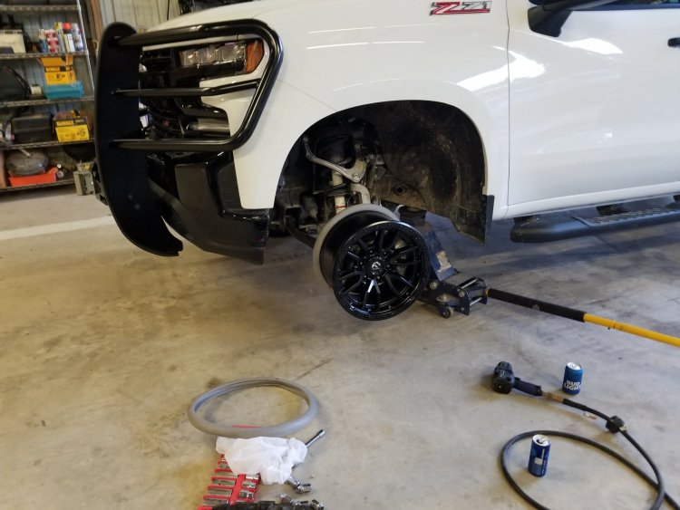

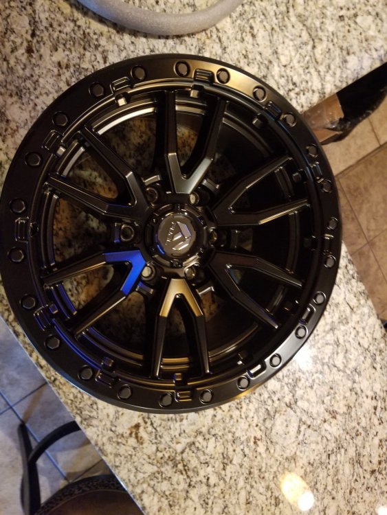

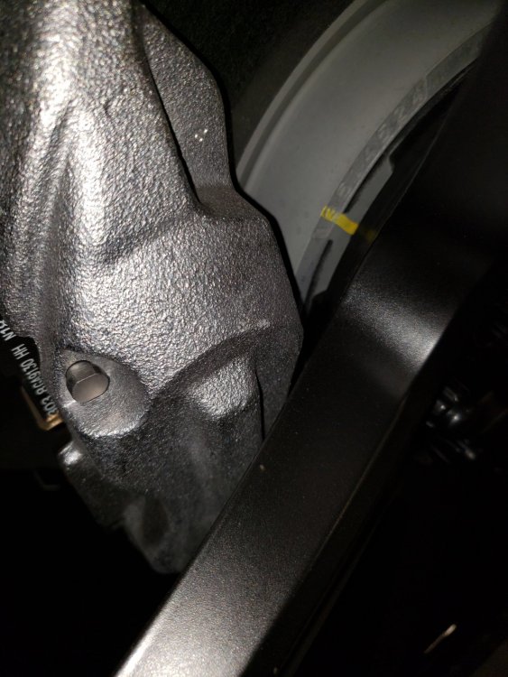

Concept One CS6, 22x9.5" +18 direct bolt on with ~2mm caliper clearance. Use able with the factory 275/50/R22s that come with the Deluxe package. I have a few more Off-Road style wheels coming to test fit next week in 17x9", 18x9", and 20x12".

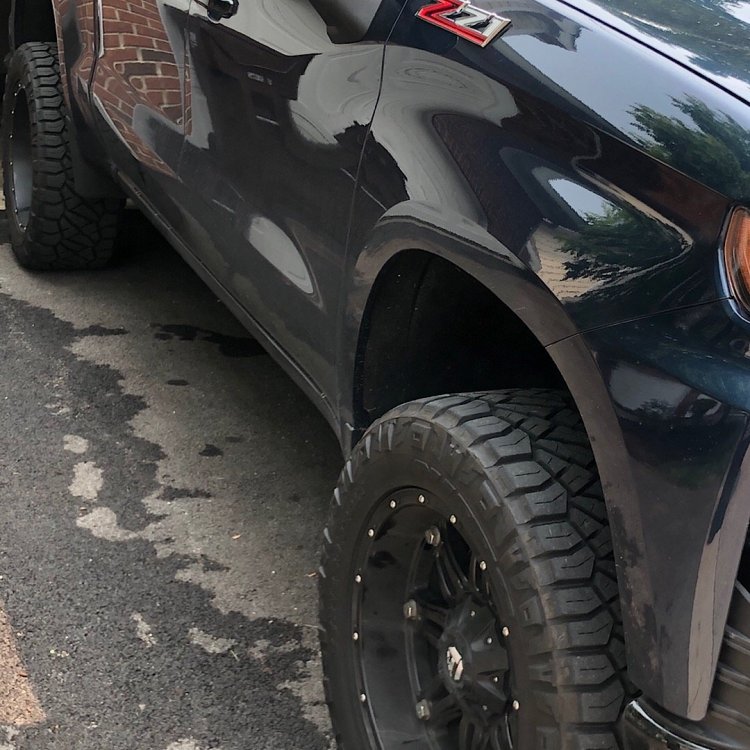

I’m running 22x12 -44 and clears just fine no problems
