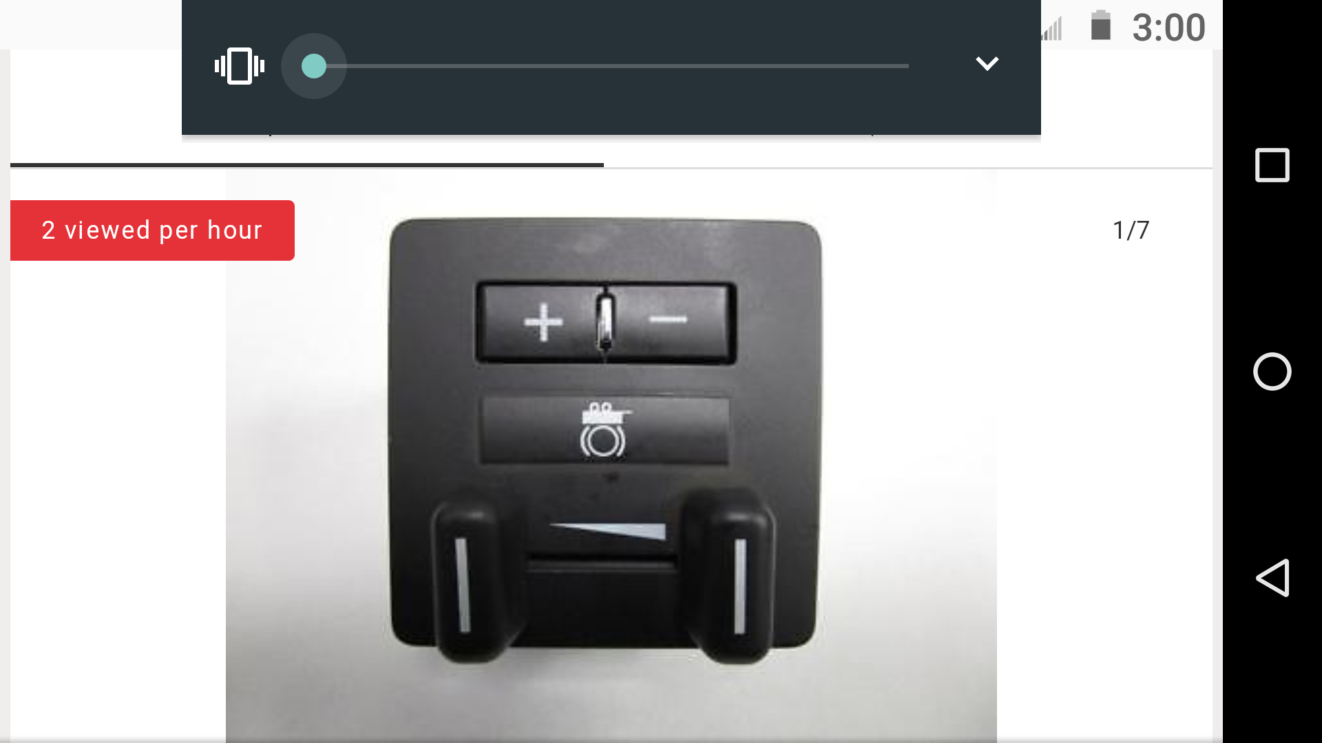

'06 GMC Sierra 2500hd. I have the factory wiring still in glove box. Inexpensive controller?

I've only seen standalone TBC's (ie, that have a small bracket to bolt it to the dash), that then plug into the junction box near the pedals.  That looks a little curved as well, so it might be for the next generation truck (7.5 and later).
But if you want better info, you should (IMHO) post the specific brand/model info, or a link to the device online.
GMT800 and older trucks did not come with a factory brake controller, the GMT800’s came prewired for an aftermarket brake control. You can use any brand - Curt, Draw-Tite, Tekonsha, etc...
You can even get a plug and play wire harness so you don’t need to splice any wires together.

The bundle with loose wires on one end and square connector at the other is called the Electric Brake Control Jumper and is for use with an aftermarket electric brake controller.  This was included and only works with those trucks originally equipped with the heavy-duty trailer wiring package.

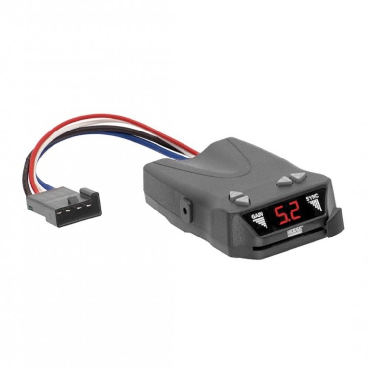

Here's one for under $30.00; https://www.etrailer.com/Brake-Controller/Tekonsha/39523.html
When I got my Tekonsha Prodigy P3, it was on sale for $99.
This is my permanent trailer braking solution on my 2006 Chevy Silverado 3500 for well under $150:
Tekonsha 90885 Prodigy P2 Electronic Brake Control https://www.amazon.com/dp/B002YIACG8/ref=cm_sw_r_cp_api_i_ujOnCb0HJA5XH
Tekonsha 3015-P Brake Control Wiring Adapter for GM https://www.amazon.com/dp/B001NZKPS8/ref=cm_sw_r_cp_api_i_GmOnCbBNMKNNN
I ended up getting this one for $33.00. pulled double axle, 3,500lbs, no problems. Probably never use it again.
