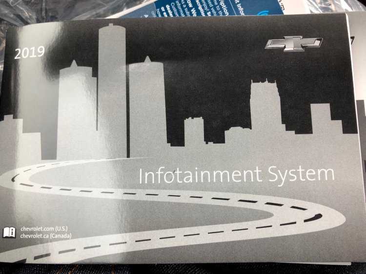

Ok, I finally looked it up.  Page 22 of the "2019 Infotainment" Guide in your manual bundle.
On the my.chevrolet.com site I found the main manual but not Infotainment otherwise I'd provide a link. :rolleyes:
Nothing mentioned about size limits or filesystem types supported that I recall, but file types are enumerated clearly.  Flac, mp3, aac, ogg, and 3gp
I've been sticking with FAT32 filesystem and it works fine.
