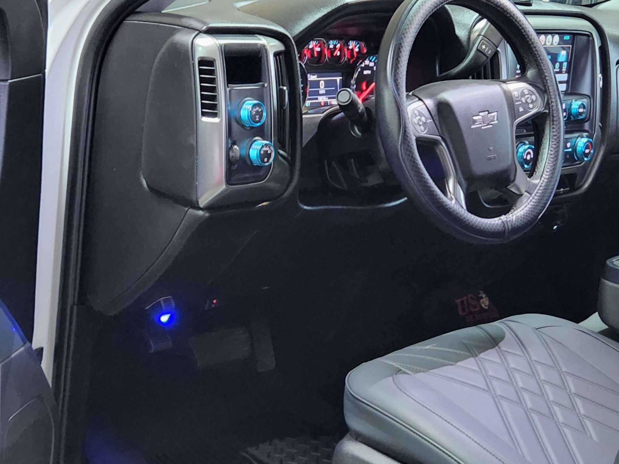

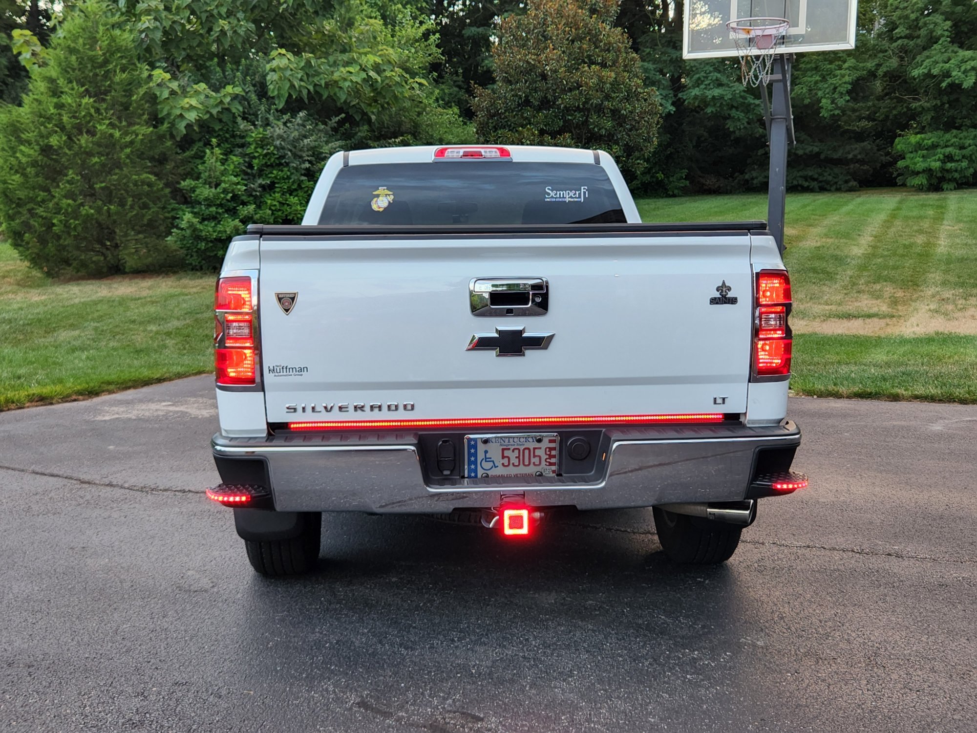

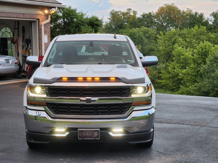

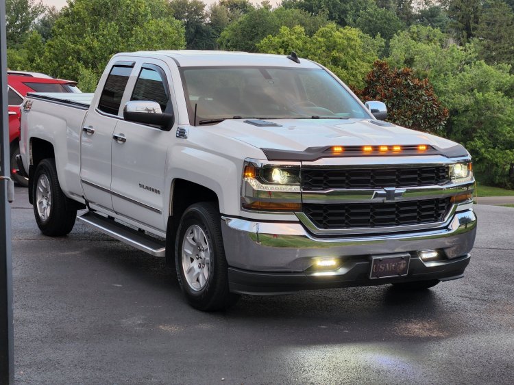

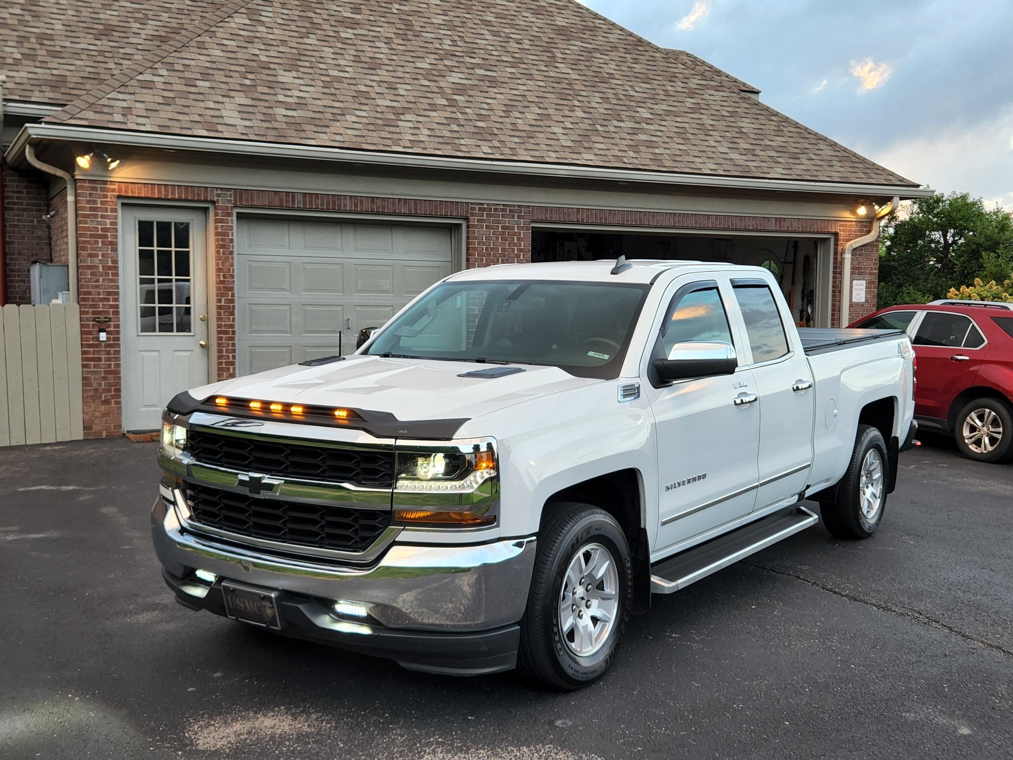

WOW!!!!  I was looking to add fog lights to my 2018 Chevy Silverado LT and was going to purchase the bumper with the fog light already installed.  The cost was 1700 to remove old bumper and install new one.  Then I saw this post.  I gotta say that I like this look a lot better.  I removed the tow hooks and bought flush lights on Amazon and wow!!!!  I connected the lights to the marker lights and they work great.  I mounted the switch down by the parking brake.  I didn't want to drill any holes, so i used a super strong 2 sided tape and it works great.  By the way, I only spent 35 dollars for the lights on Amazon. I think the fog lights look awesome with the lighted bug deflector.  I even added the running boards and rear bumper lights on the steps.  Here are the pictures of my Silverado.  I basically turned my LT into a LTZ with all my upgrades at minimal cost.  I am pretty darn happy with this truck.  I get pulled over a lot by other Silverado owners asking questions.   I may replace the back glass with one with slider.  I added leather seat covers and installed a safe under the center console.  I also installed a wireless phone charger on the center console.  I also may take off the 17 inch wheels and install 20 inch.  What do you guys think?20220718_204946.thumb.jpg.175cfcf149720fd9c1c70079d92654b4.jpg
Edited by K Austin
Added new photos
