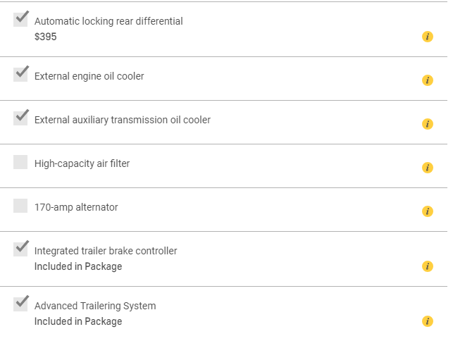

Using the Chevy build tool, it doesn't make sense that the LT Max tow is missing the tranny cooler and the LT Trail Boss is missing the tranny and oil coolers when the LT Z71 has both.
Is the tool not 100% ???
Does the LT Z71 really have both coolers and the LT Trail Boss doesn't ???
Could those be added to the LT Trail Boss after delivery ???

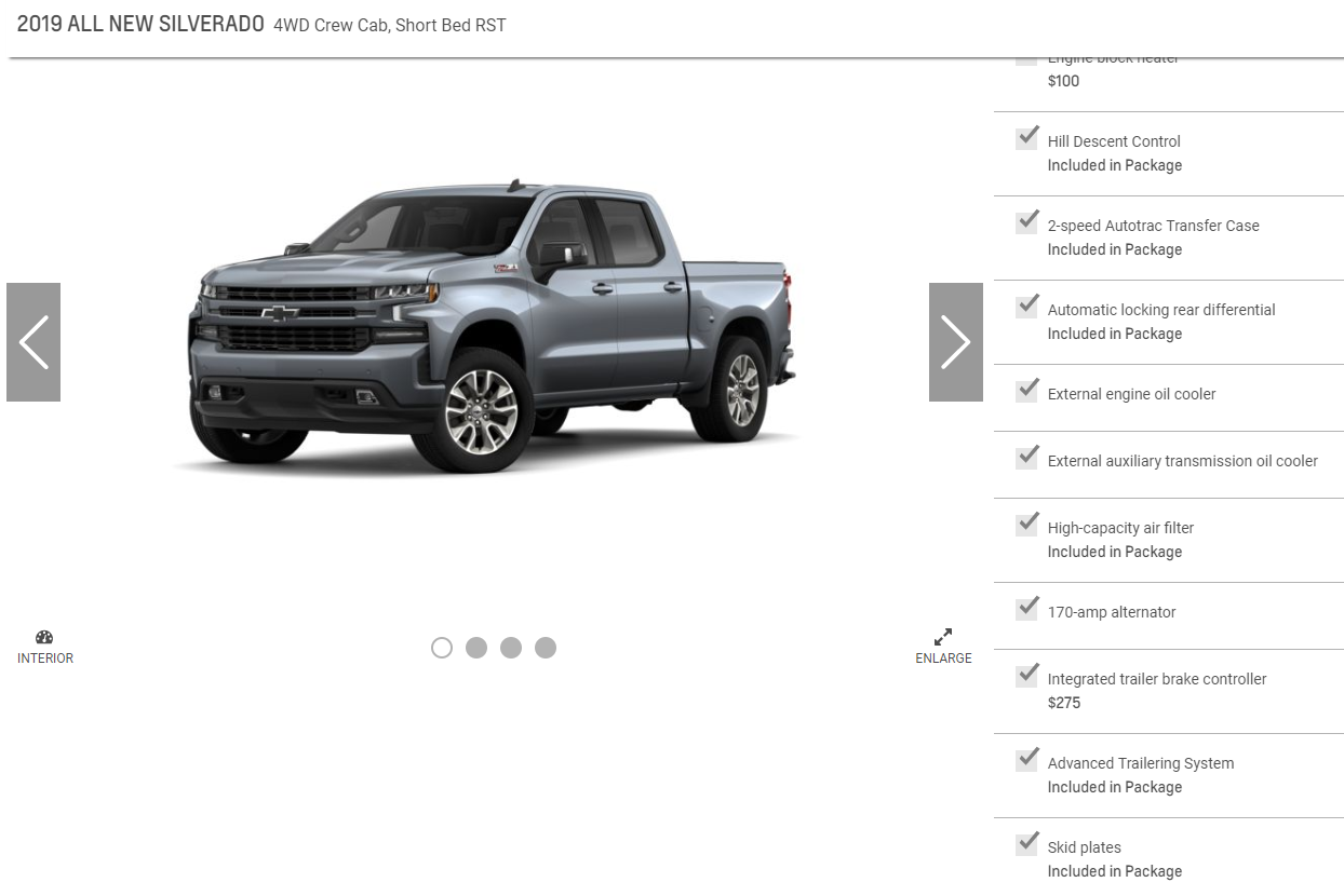

Even the RST Z71 shows these trailering items and it is basically a LT with black bowties and no chrome and the ability to have cloth buckets.

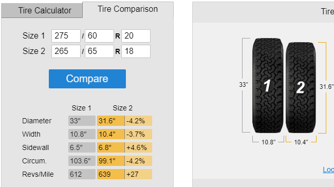

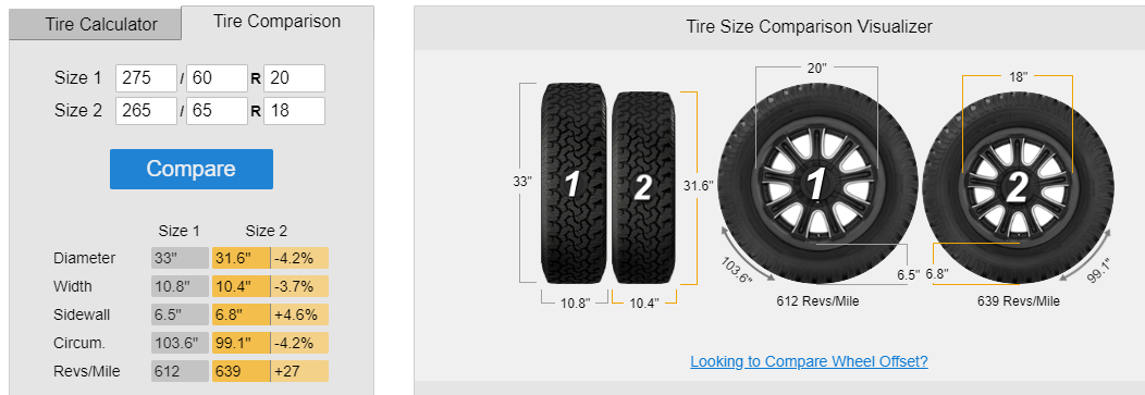

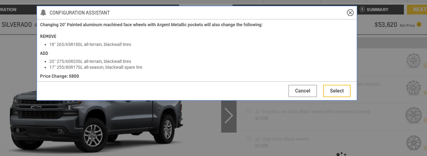

It also appears that selecting the 20" wheels over the 18" wheels not only changes the wheels but also the tire size from 31.6" to 33". So not much sidewall changes.

My Trail Boss LT has push button start and auxiliary external transmission oil cooler, doesn't say anything about engine oil cooler on build sheet.

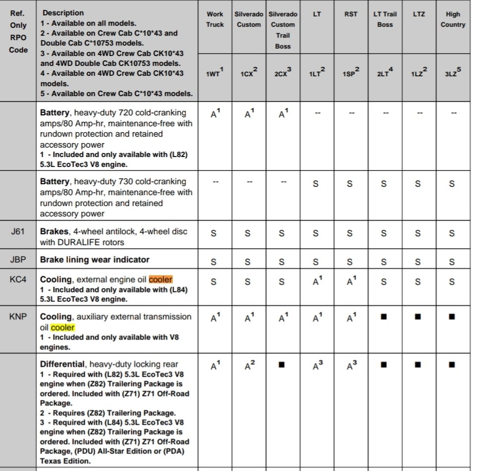

The Trailboss comes standard with the engine cooler and trans cooler.  Both are only available on the LT and RST with the 5.3L V8 motor.  Also, the Trail Boss can tow a maximum of 9500 lbs.  Any other questions, let me know

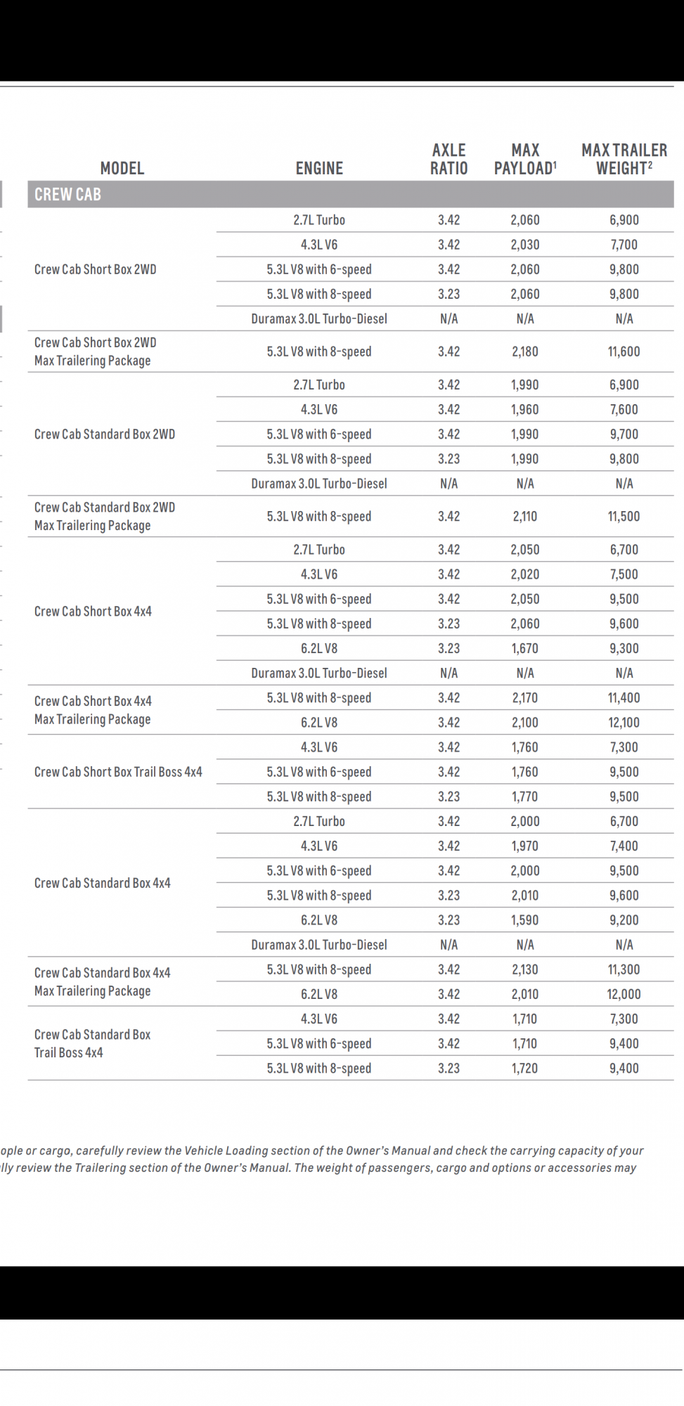

4. What is the revised towing, payload, and tongue weight for this configuration (NHT)?

Any idea what the payload and tongue limits are with this config?
That I don’t. You should swing by a dealer and grab a brochure if they have it. I don’t have it handy, but it is HUGE and has all the specs at the back. Seems more detailed and easier to navigate than the website. You’ll want to have the book if you buy the truck anyway. ?

No dealers have NHT unfortunately. The brochure posted above has the numbers I was looking for.  ??
