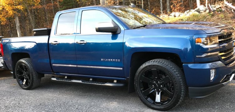

22 hours ago, Kevin0311 said:
I have the black 22 shown off my 17 silverado i tried to fit on 19 but do need a small spacer for fronts to clear.  Had no idea about tp sensors being different.
any thoughts about the ones that came in my glovebox ( for trailer) with my truck, could they be used if i too find out myself the older gm ones dont work? Running stock 20 with winter tires and 22’s for the summer
No, the included TPMS are for trailers and won't work.  The part number for the new sensors are 84413357.  Do you know what thickness spacer you'd need for these to fit the '19?  The best way is to use washers until the wheel clears then measure the thickness of the washers with a caliper.
Boy lots of good news, thought i did good holding onto these and now rims dont fit, need new tpms sensors ugh
my mechanic said just hits spokes 1/8 spacer would prob work, 1/4 is thinnest i could locate and didnt even think about the hub.  When warmer will check front myself and use washer method to get more exact measurements
sounds like safest would be getting thinnest bolt on spacers that are hubsentric which are 1 inch if i remember correctly, got a feeling the 2 inch wider stance wont look good
