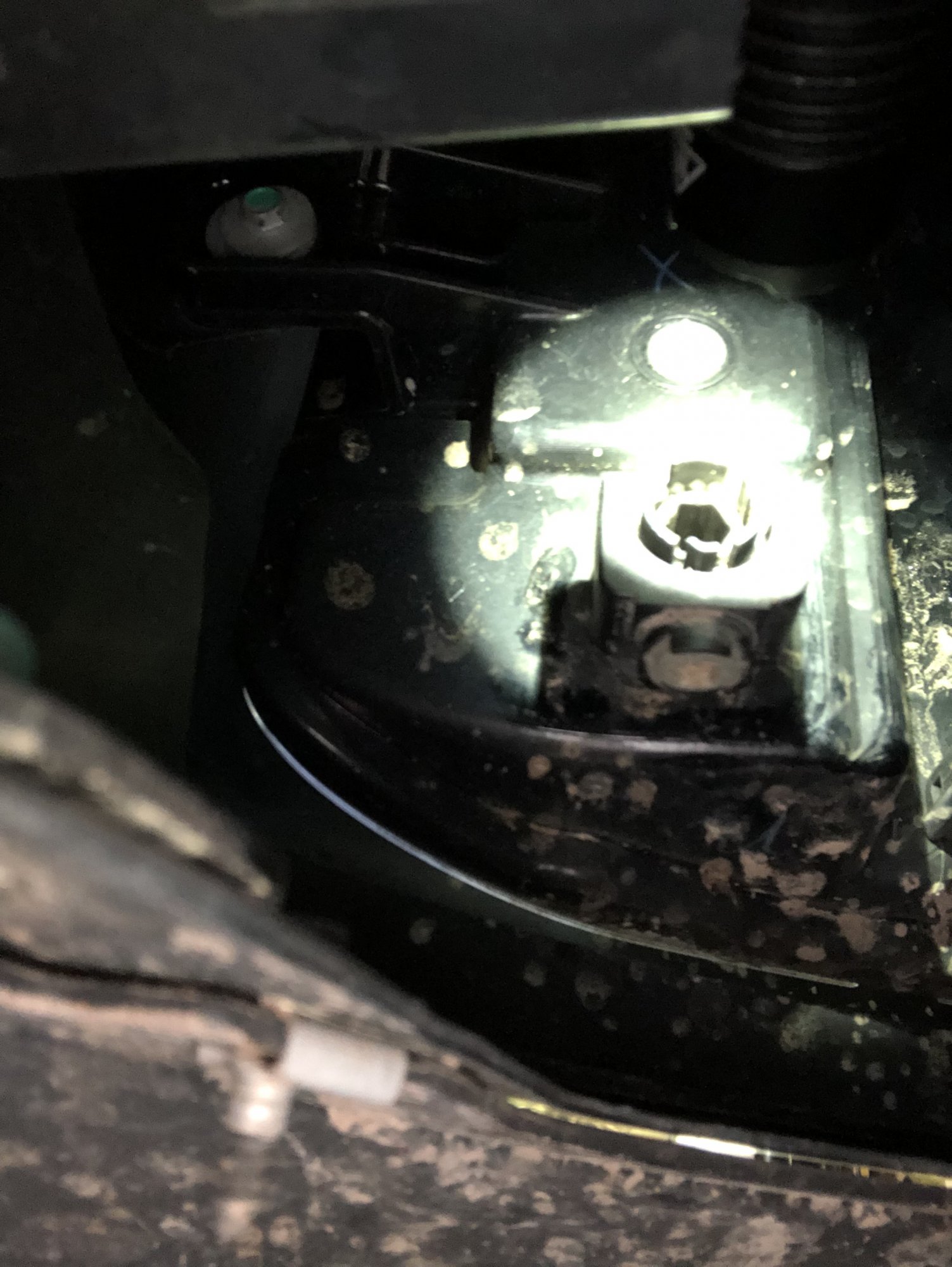

I raised the truck and adjusted the headlights but is there an adjustment for fog lights ?

I’m having to adjust the fog light, and got down there to find what i thought was the adjuster, but when I stick a screwdriver in there to turn it, it just seems to spin freely. It doesn’t do anything. Do I torque the white portion that faces the ground? Or do I find a huge Allen Wrench and torque the portion that points parallel to the ground?
Update: Got down there again with a 8mm hex head, socket wrench and torqued the circular adjustment that runs parallel with the ground. That did the trick.
Btw, counter-clockwise lowers the light, and clockwise raises it. Torque it too much counter-clockwise, and the assembly will want to come out completely.

What year is your truck? I haven’t been able to look at mine in a while as I live in the northeast and there is always snow on the ground.im going to look tomorrow though are you lights th same as these?thanks
Yessir. I’ve got a 2016 Z71. That’s my front end pretty much. Right in back of where those fog lights are is the adjuster, which is what is shown in my attached image. You don’t even have to take the tire well apart. I got a socket wrench and an 8mm hex head attachment for it, and crawled under the front fender. That adjuster should be easily visible. It has a white knob underneath it. Not sure what the white knob is for... i think i broke it. That’s why I had to attack the larger portion with the 8mm hex head.
Anyway, you can pick up an 8mm hex head from AutoZone or Oreillys or whatever auto store. Really easy to get to because there’s a gap between the corner front bumper and the tire well.

That white knob would not budge for me and I didn’t want to strip it and I searched and there was no info out there and winter came and finally someone responded to this thread,thanks again. I have a 2.5 level and sitting on 33’s so when I drive up behind someone I light up the whole inside of there car so need to adjust them down as I did already with the headlights,I’ll be picking up that 8mm hex head first thing tomorrow.

So after turning that knob counter-clockwise using an 8mm socket, you verified the fog lights did in fact lower? But then you also mentioned if you turn counter-clockwise too much that the assembly will want to come out. So did you just have to turn it counter-clockwise the perfect amount to where you wanted it lowered without falling out?

I have a 2018 Silverado and my factory fog lights have no adjustments screws shown in the picture. Mine are completely different. So is it possible to adjust them. I have a 2inch leveling kit and when I use my fog lights I get flashed all the time. I can see when driving they are aimed pretty high. I adjusted my headlamps. Anyone have any idea how to adjust fog lights on a 2018 Chevy Silverado 1500.
