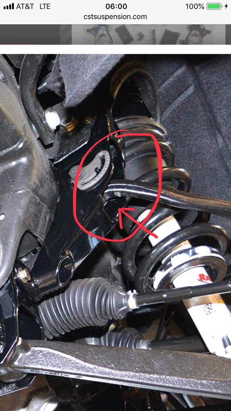

Looking at pics from their website (below) the new brackets do not appear to have new bump stops. There is only a thin line of metal below to bottom of the UCA. This line looks too low and close to the frame to have any impact on the UCAs movement. Stock bump stops are much thicker in this area too.

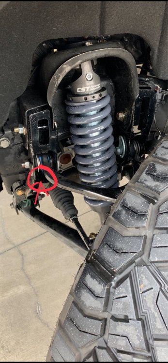

can you take take a pic of your CST stops please? The pic posted above was taken from CSTs website and it does not appear there are any stops. I’m not worried about bottoming out as that’s compression (upward travel) of the suspension. I am curious what stops the wheel and control arms from going down when the wheel is in the air.
Check out these pics and the lack of bump stops for the CST brackets vs the stock ones. The CST only has the think price of metal that is low and recessed, it appears to be there for structural support/boxing of the bracket. It does not appear to be a stop.
STOCK;
CST;
