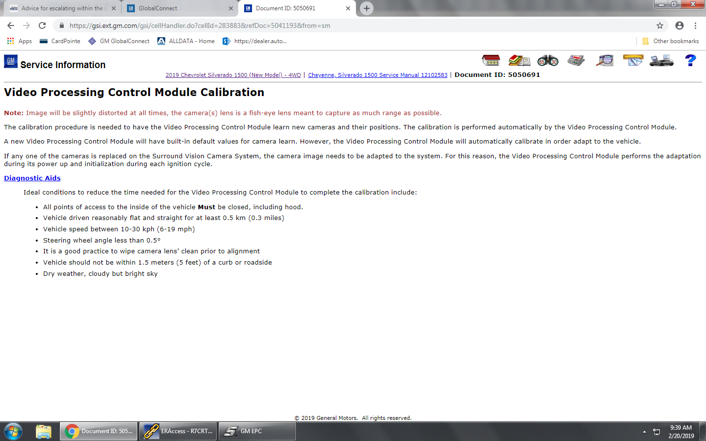

As said above, it is the Bodyshop's responsibility to return the vehicle to you as it was before the accident. The Dealership should be working with the Bodyshop to correct the camera operation and alignment. There are a couple of connections and camera to check to ensure proper operation. Alignment also needs to be completed. Warranty wise in this situation, I believe you [Insurance] would be responsible for the entire cost of work done by the Dealership. Ask the Dealership who is covering the cost of the work performed. If the Dealership informs you that it is Warranty work, call Chevrolet Customer Care and explain the problem and answer their questions. They will contact the dealership and a resolution will be forthcoming. If the cost burden falls unto the Bodyshop, ensure the action and monies by the insurance company are covering this camera repair.  Normally the Bodyshop and the Insurance Company will have a relationship that states "The Bodyshop material, labor are guaranteed for a length of time." You can let the dealership continue with the repair or take it to another for repair. If this is the dealership you purchased the vehicle from, it seems they would be on top of this. As you have done, talk to the SA and also the mechanic working on the vehicle and find out what the problem is. Explain your situation to the Dealership and ask for the timetable they need for the repair. It is great that the Bodyshop did a great job on your vehicle. I had my bumper, grill, headlight, extension replaced on mine. Being Pearl White, resulted in the fender extension and bumper not matching the rest of the vehicle. They replaced both twice and they finally just took a set off another vehicle that I approved of. This was simple since the Bodyshop and Dealership were operated by the same organization. Good Luck with your situation. Keep us updated please.

Thanks for the advice.  Chevrolet dealer finally figured out how to reprogram the camera...it sat there for 10 days.  Not sure what they did but I'm going to go by and get the paperwork that has the tech's "story" on it sometime next week.
