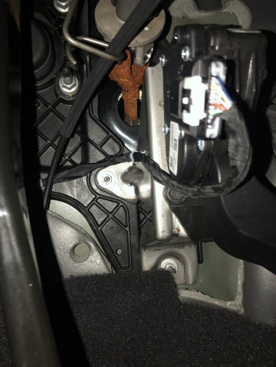

22 hours ago, EpicLT said:
Here is a bit of a closer picture:
Maybe this won't ever be a problem.   However, I would take my truck to the dealership and politely tell them it is unacceptable.   You want a properly coated replacement piece for your peace of mind.  This is a powerful picture and when added to the fact that this is an integral part of your steering, I doubt you will get much of an argument.  Let us know what they say and do!

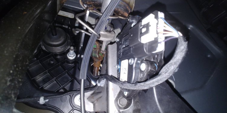

I get a pic of that in the AM. I'm curious too. Hey not only is it rusty, it could be faded too.
Sent from my SM-G920P using Tapatalk
Well this is about as good as I could get.
It appears sealed up well on the inside of the boot and there is grease on the upper portion of same. I don't think any type of creature could enter at this point and no cold air could filter through.
Making a mountain out of a mole hill IMO.

@Donstar I know you wanted an update. Went to my local GM dealer and they ordered me a new steering shaft for warranty replacement. I showed them a picture of my other truck’s shaft and they said that mine was excessive rust. So I don’t know if that means that others would not get replaced that are more surface rust.
It is definitely just surface rust on an unpainted piece of steel. The same shaft is going to go in. When they replace it you should get under there and cost it with some type of oil or grease if it concerns you that much. A little piece of scotch bright would have cleaned that right off.
