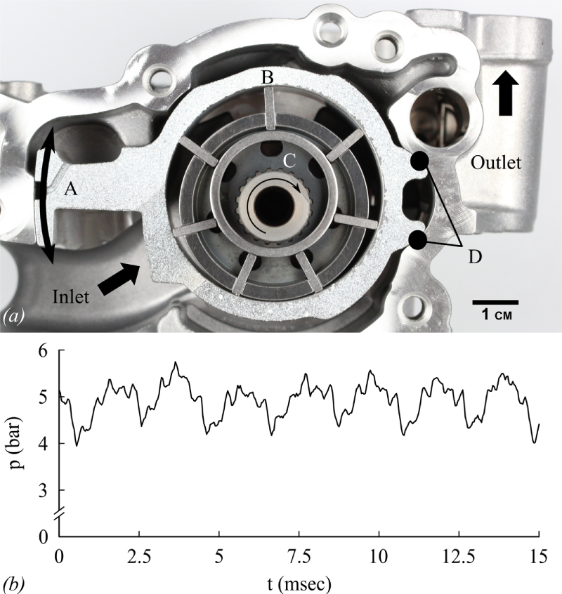

The oil pump on these engines is naturally more noisy than a gerotor oil pump. Our engines use a vane-style oil pump and the earlier version of the pump made noise no matter what. Probably due to the spacing between vanes, which can create pulsation noises (harmonics) that are heard but doesn't mean there's anything wrong it. It's similar to the noise you'll typically hear from a big hydraulic pump. It's up to you though. I don't blame you for wanting to do something about it. It's hard to judge what's normal and what's not. My pump is noisy but the noise is similar to what it was like when it was new.
variable_displacement_oil_pump_detail_f16aa92474d4f3c8bc553eaf3103691002f76541.thumb.jpg.daeb2e761c8516dc9df132080546e13a.jpgariable-displacement-vane-pump-a-A-adjustable-cam-ring-B-vane-C-rotor-D-pivot.thumb.png.cc218dc041ce936fef37fb33bb766158.png

Thanks for the info and pics. My truck was built late 2013 so it’s possible I have one of those early, noisy pumps. I don’t ever recall it being this loud though. And what confuses me is it isn’t always the same volume. Sometimes it’s loud and sometimes it’s barely noticeable. I haven’t been able to pinpoint under what conditions it’s loud and what triggers it to stay quiet.

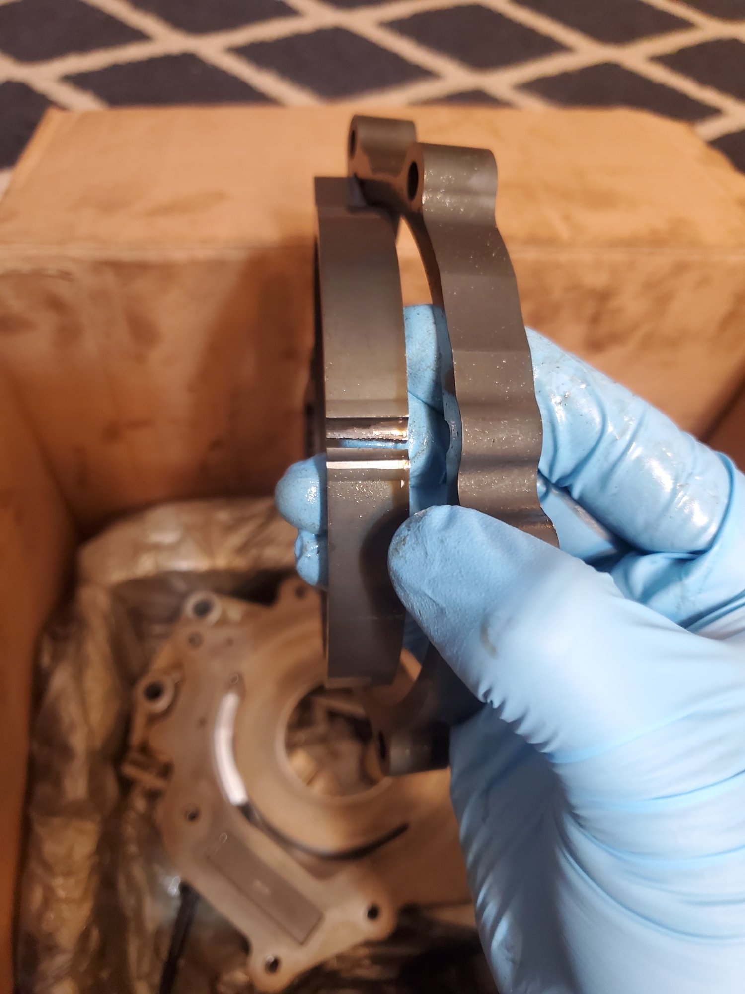

Mine l83 oil pump failed. I was making pretty bad whining noise. Code P06DD. Replaced it with new pump. Gm Part #12686433. Open up my old oil pump oil flow solenoid seemed working fine. But it was broken from inside. I assume whining noise was coming from those fan style pivots, I assume those were hitting constantly to the broken part.
