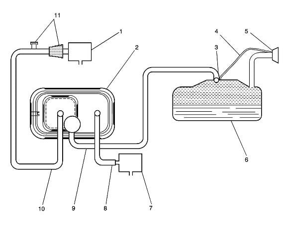

Here is the way this system works. When you fill the truck you put the gas pump in #5 the fuel neck. Fuel goes into the tank #6 and then the pressure goes out to the canister#2 in pipe #9. The pressure then goes through the canister #2 and comes out the vent hose #8 and then out the vent #7.
If you're having a problem it is probably either the canister #2 (most likely) or the vent #7.
Here is the way you can check. Disconnect the pipe at #8 where it connects to the canister. Take it and get fuel. If it fills fine replace the vent. If it doesn't. Disconnect the pipe at #9 at the canister. Get fuel. If it fills fine, replace the canister.

The evap cannister is used to capture fumes when the system is sealed (gas cap on) and pressure needs to dissipate.
When filling, the air is released through #4.

The only time number 4 vents is when there is no fuel being put into the system and the pressure is so high that it actually pushes the tamper ball up allowing the neck to vent. Older trucks and cars without a tamper ball you are absolute correct. But on this vehicle when you fill it pushes the tamper ball in blocking off the neck vent. this makes it so it has to go through the charcoal canister and help with emissions. When the gas cap is on and you are driving. If for some reason (lets say the vent was stuck closed or the canister saturated with fuel from over filling) then the tamper ball would move up allowing the neck to vent so the fuel tank would not pressurize and split at the seams.
