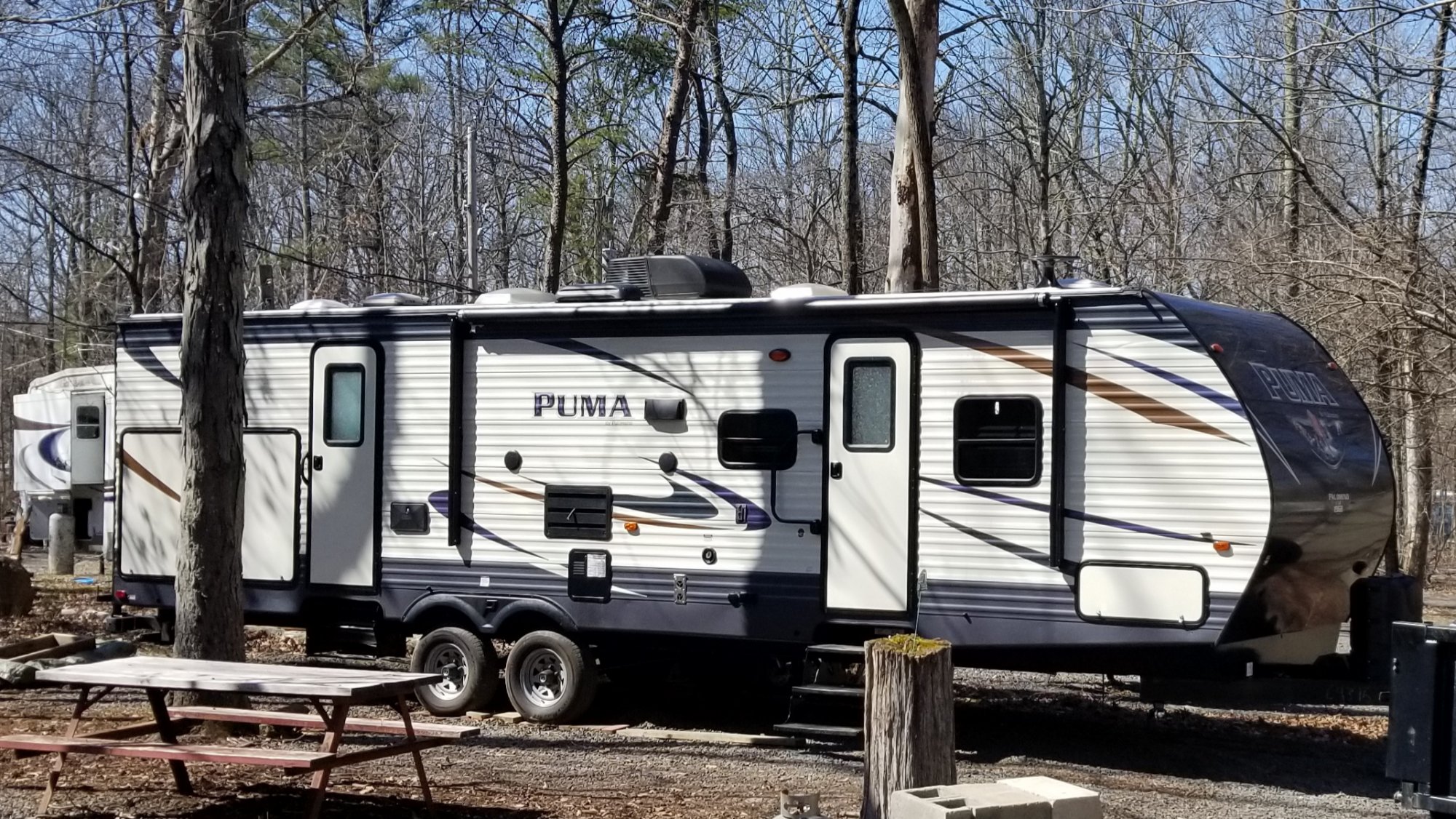

Unsure on tounge weight you can also use a bathroom scale with some wood set up that method is listed in most trailer owners manuals. It's a neat trick I ran across in my research, recently towed a 35' camper was about 9600lb with a different vehicle.

Here is what I moved last week, not with my Chevy. This would squat both my Chevy's. And be very unsafe.
