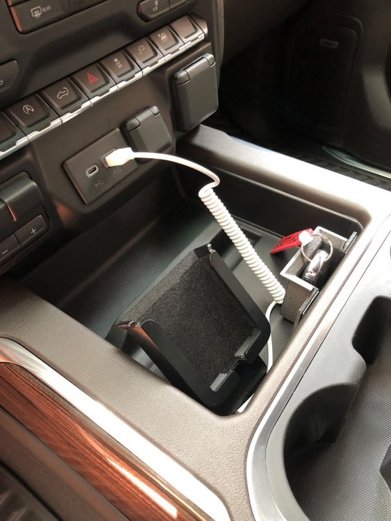

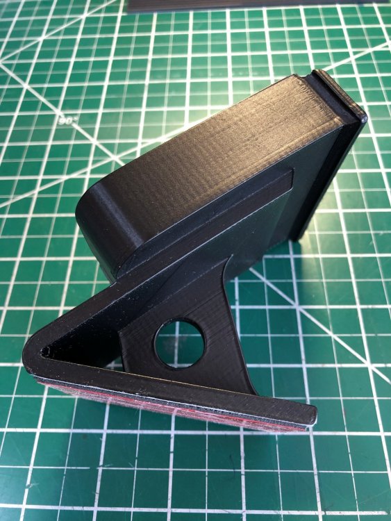

Played a little bit more with my 3D design software and 3D printer and came up with a holder that fits my iPhone 8 phone with its case.
Allowed for a little bit of extra room in-case I swap out cases. Printed from Tough PLA from MatterHackers, rubberized coated, added felt lining and rubber bump stops to the bottom, and designed for the Lightening cable attach when holstered.
The way I mounted it was by cutting the rubber liner in the console to the exact footprint of the holder, and then used 3M VHB double-back tape to attach.
Slides in and out with no problem and gets it out of my pocket when driving, and allows me to see texts and alerts. Key Fob holder also in picture that gets everything out of my pocket on long trips.

This is really nice. I love the console area in the T1 bucket seat set up. I have just been standing my iPhone XS up in the area provided, but this would be nice so I could stand it up AND plug it in.

I used the Tough PLA from MatterHackers that has an advertised heat deflection temp of 60 C (140 F).
