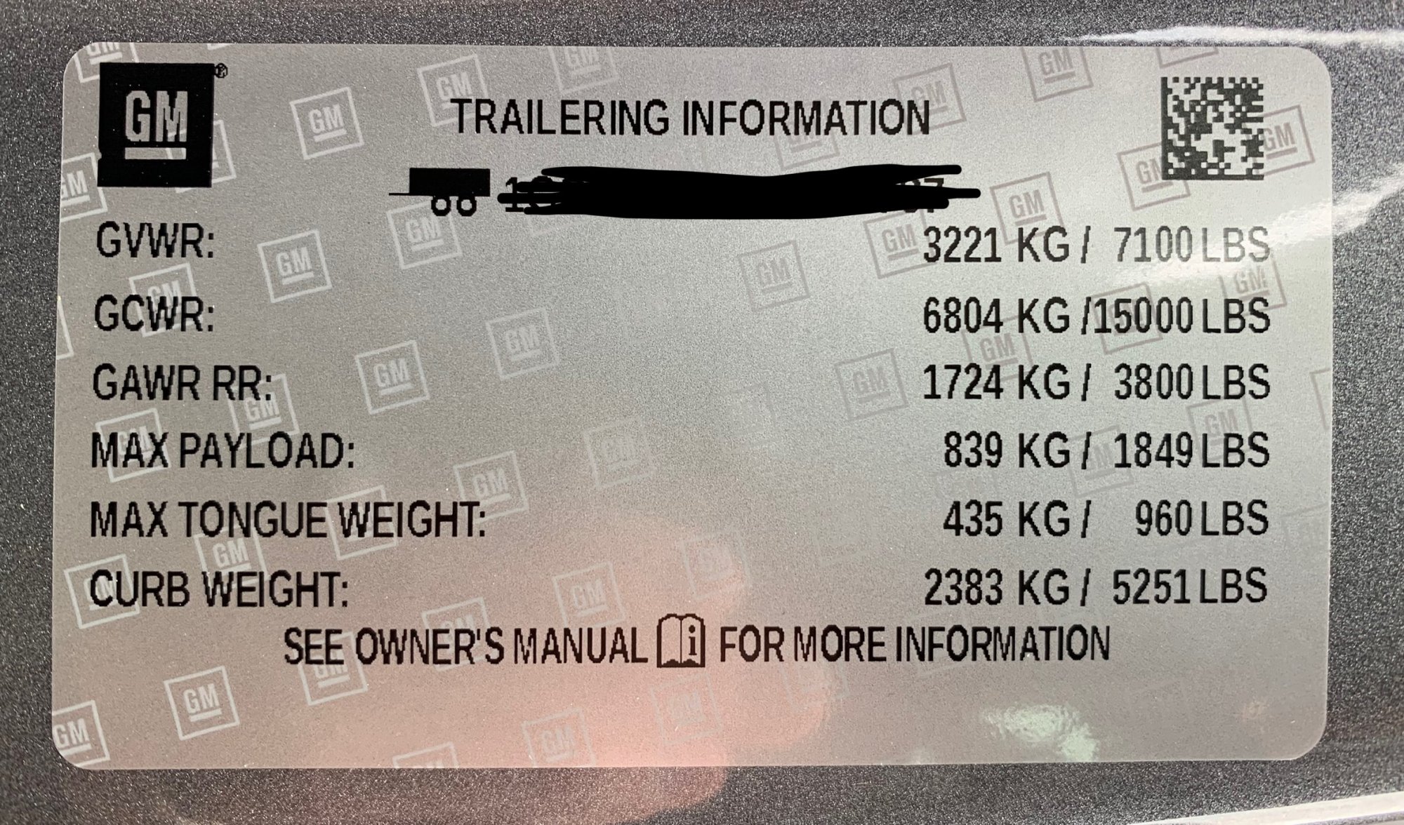

The Tos Posted April 24, 2019 Posted April 24, 2019 I have a Crew Cab 2019 z71 RST 5.3L with the 3.23 gears. From what I understand it can tow 9600lbs and can handle 960lbs of tongue weight on the hitch? My camper weighs about 6400lbs dry and has a 720lb tongue weight. Its towed great with my 2016 double cab 5.3L with 3.42 gears. I just wanted to make sure I understood the numbers correctly.
z1boss Posted April 24, 2019 Posted April 24, 2019 8 minutes ago, The Tos said: I have a Crew Cab 2019 z71 RST 5.3L with the 3.23 gears. From what I understand it can tow 9600lbs and can handle 960lbs of tongue weight on the hitch? My camper weighs about 6400lbs dry and has a 720lb tongue weight. Its towed great with my 2016 double cab 5.3L with 3.42 gears. I just wanted to make sure I understood the numbers correctly. Your tow rating is on your door. There should be a sticker specific to your truck's configuration

econometrics Posted April 24, 2019 Posted April 24, 2019 3 hours ago, The Tos said: I have a Crew Cab 2019 z71 RST 5.3L with the 3.23 gears. From what I understand it can tow 9600lbs and can handle 960lbs of tongue weight on the hitch? My camper weighs about 6400lbs dry and has a 720lb tongue weight. Its towed great with my 2016 double cab 5.3L with 3.42 gears. I just wanted to make sure I understood the numbers correctly. You have the same truck that I do. Here's the sticker on the inside of the door, which confirms the numbers you're giving here... The My Chevy app also has a nice Trailering Calculator you can use to sort all this out.
