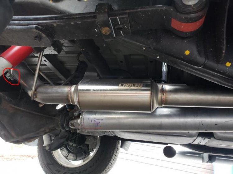

Yes, just loosen at the flange just after the third cat (right before catback) and at the flange just after the muffler (circled in red...I didn't see one before it. If there is one before it then loosen that one instead). Then rotate the assembly clockwise (when facing front of vehicle). That will give you a little bit more clearance over the cross member as you're essentially rotating it up from the connection at the rubber mounts. Then check to make sure everything rear of the system lines up. I had this issue with my borla and just rotating the pipe worked out fine. If this doesn't work, then call them.
